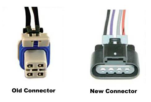

No, this Bosch unit assumed I had the OE connector, which is square. It seems that the fuel pump in this truck has been replaced once already and had the new style converted. The one on the left is what fits this new Bosch unit that I have installed.

Oh snap. Okay, so I found these two, not sure which to go with
Racetronix - Connector, Fuel Bulkhead 4-Way 280/150

on the new pump look wires that plug in the bulk head from bottom .match up to the bulk head .the 2 bulk heads in your thread plugs in different from the bottom side.
This is the correct fitment. Thanks everyone.
On the left is the bulkhead from the Bosch BS67305 Fuel Pump on the right the connector from the harness.
Here is the connector from the pump to the bulkhead. As you see they match the bulkhead I ordered.
