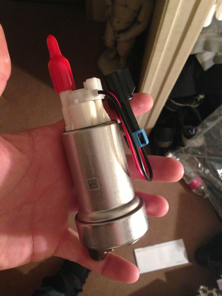

You need 2 of these. Or at least walbro 400's if your not planning on E85.
