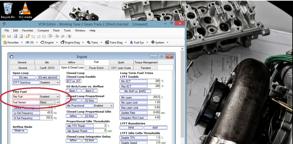

I plan on doing this also when I get back from deployment. You shouldn't have to get it tuned for e85 so to speak as that's what the sensor is allowing the PCM to use it's tables to adjust fueling(possibly timing too) for the ethanol %... Which I'm sure you know or you wouldn't be doing this lol... Just clarifying you mean just tuning to enable the sensor..
Hope it works like it should, keep us updated..
