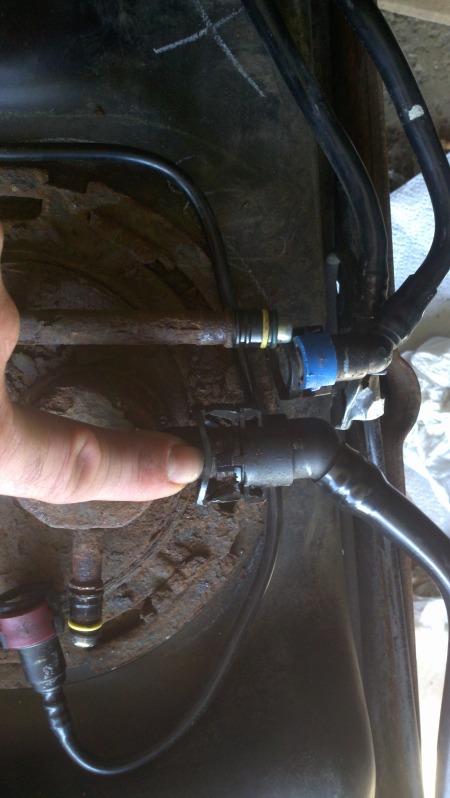

As I said, here's pics.
U don't wanna see this, but if u live in Rustbelt, or near coast, corrosion doesn't play favorites.
Look where steel lines meet nylon. There are O-rings, the black behind O-rings is supposed to stay inside lines. I asssure u, u don't want this problem. :bang;

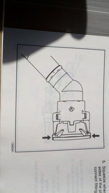

All nylon lines entering fuel pump module likely don't suffer from this either, I'd think. As what John has in link I had in that other post. This big retaining clip should come off as 1 pc., not separate into 2.
