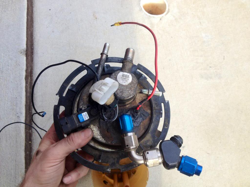

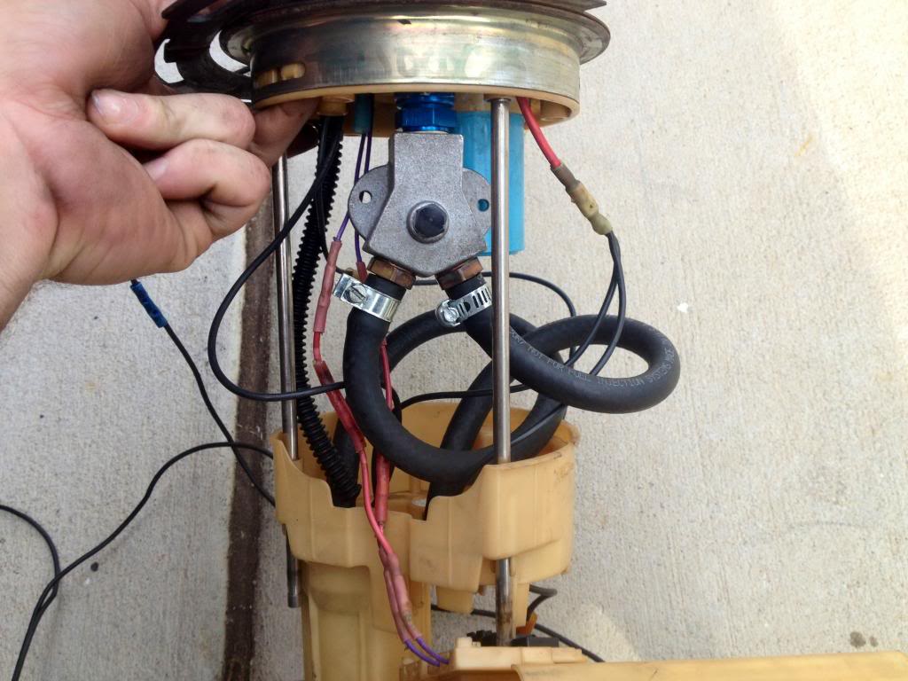

Also always get asked how did my duals. It's not fancy, at all, but works or did anyways.

If you want to send one to me ill be glad to take it apart for you
