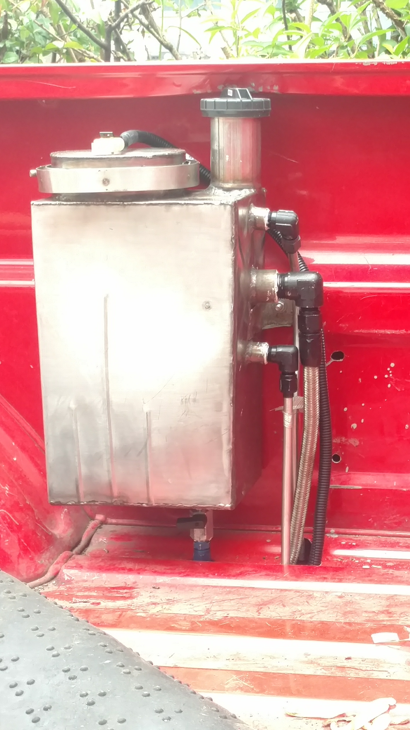

I have one. It is fed by the return and has three Denso 1020s that come on as soon as the engine vacuum drops. No slosh, solid constant pressure.

Pictures please?

It is in the bed in front of the left wheel well. The lines, clockwise from the top right, are return from the engine, supply to the dual inlet/outlet fuel filter in the engine bay, return to the main tank, and a drain line that is teed into the return under the bed. I can open the valve under the surge tank and drain it for maintenance. On top is the lid, which is a 5" v-band with a cap welded on. I put a viton gasket between the flanges. The cap has the Racetronix bulkhead electrical fitting. The thing on the top right that looks like a gas cap is a gas cap. It serves as a vacuum breaker, but also keeps the fumes inside.
I tell anyone who asks that it's an auxiliary tank. That is a satisfactory answer to 99% of them.

thats dope
