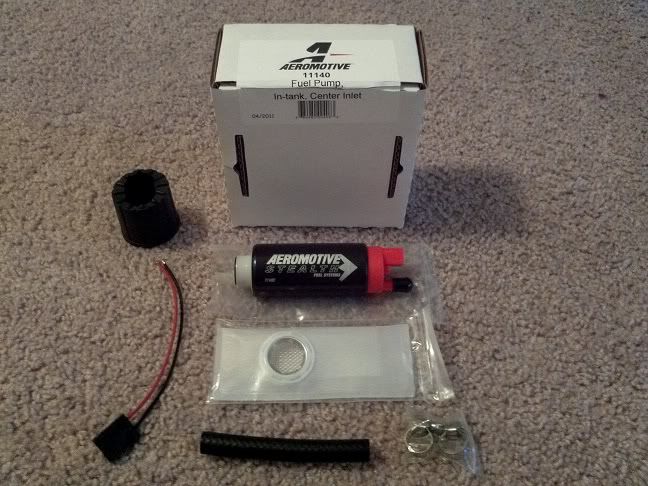

This is what comes with the 340. I dont know why they include such a short hose with the pump, so you do need to get a foot of submersible fuel line.
Go to the parts store and order 1' of gates submersible efi fuel line. It comes pre-packaged, and should be 20-25 bucks. Also pick up 2 fuel line hose clamps for it. (He said in another post to get the kind of hose clamp that doesn't cut into fuel lines. I don't know what that means though.)

So I ended up ordering the Aeromotive 340.
First off, it does appear that there is a check valve.
I need to order a wiring kit for my fuel pump now and I'm a but confused.
It says in the small print on the racetronix website that there are 2 versions of the pumps, one white, one red. Now, I assume that any pump ordered today will be red. Where I'm confused is on which kit folks are ordering.
It says on the bottom of this page what kit to order if you have a red or white pump.
http://www.racetronix.biz/customkiti...=FPWK-017W&eq=
Then there's this kit.
http://www.racetronix.biz/customkiti...FPWK-017WX&eq=
It goes as far to mention that it's longer for GM Truck/SUV applications.
What kit are folks using? The second one is roughly 10.00 more. It seems like if the only difference is wire length, one could easily solder in longer wires.
I emailed racetronix twice and haven't heard back from them. I'll be running this in a 2000 Silverado.
