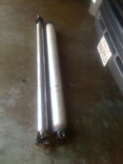

Had a custom drive shaft put in from Wenco Yesterday. Thanks Eric (1slowz71) for showing me this place. The old drive shaft was rubbing on a cross member under the bed of the truck after I did my 2/4 drop a year ago. I didn't realize how bad it had gotten. Tundra aluminum drive shafts are not that thick and i had at least a 1/8" grove.
The new drive shaft is made of steel and has a smaller diameter but is slightly thicker.
Acceleration off the line seems a little better but it could just be in my head. Any one know if this will help/hurt performance or will it be the same?

Damn!!!! You almost lost that thing! Im not sure if it would make much of a difference. I know a lighter drive shaft works similar to lighter wheels in the way of rotational mass but I have never looked into it much or ridden before and after a major change. I would almost be tempted to cut it open just to see how much material you actually had left.

Yeah I guess the bigger the diameter the thinner the wall can be. That's why Toyota uses 5" diameter aluminum tubing. The guy at wenco said I was about 1-2 good hits from snapping that sucker. It also had a slight wobble on the freeway that caused a little vibration.

pretty strong stock driveshaft if you ask me. A gm driveshaft would have blown up, and taken everything out...
