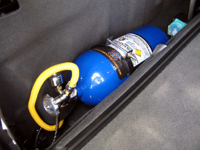

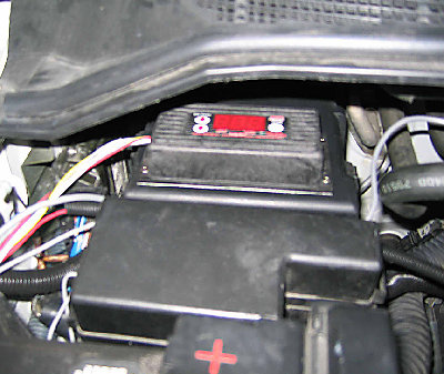

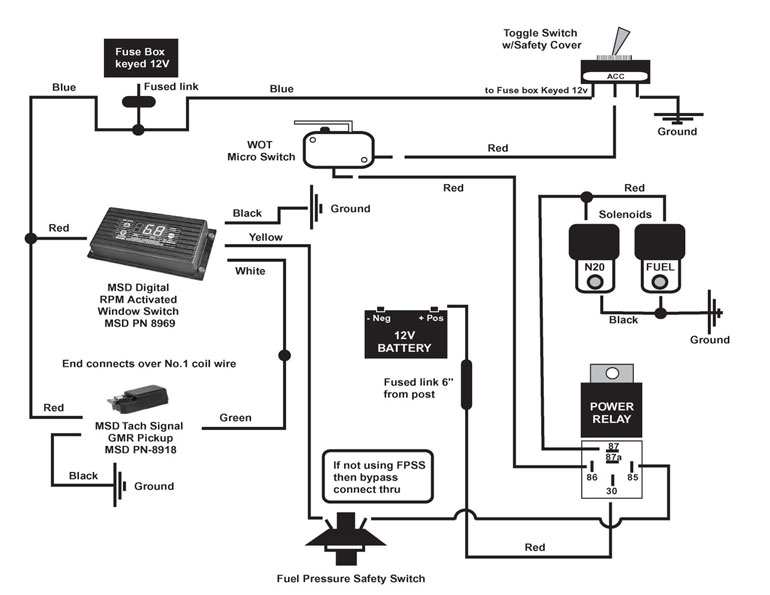

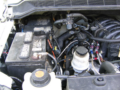

Here are some pics of the project for the white beast.
Attached Thumbnails Nitrous Installed-t_window_switchsml_811.jpg   Nitrous Installed-t_foot_switchsml_188.jpg   Nitrous Installed-t_my_setup_-_bottlesml_142.jpg   Nitrous Installed-t_my_setup_-enginesml_728.jpg   Nitrous Installed-nitrous-layoutsmall.jpg

Ran out of gas this weekend doing initial testing. Times are coming soon enough. trick is to find that jetting sweet spot as the traditional jet combos are a bit rich.

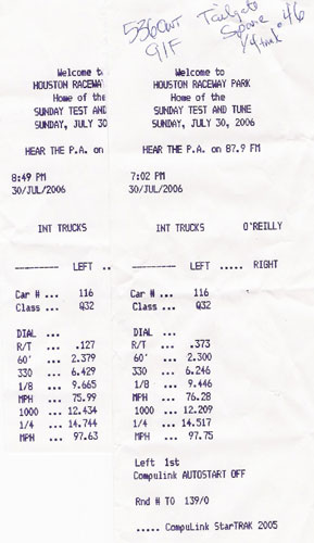

Default Times are here
04 Titan Crew Cab 44,300miles - Race weight 5360lbs.
Ran a 14.51 @97.75mph 1/4 HRP July 30,2006 Temps 91F
Wet Cold Fusion, Nytrex nozzle, Bottle 950psi, Fuel 51psi .046 x .025 = 81 WHP
Stock cam, stock peg leg 2.94 gear, stock manifolds, stock 18's, running boards, tailgate, spare, baby seat, jack all included.
MODS: N20, Volant CAI, Banks Monster.
3.36 gear and detroit trutrac going in tomorrow.

Here ya go...timeslips for 14.7 spray at 3-5500rpm and 14.5 spray at 2600-5500rpm.
My detroit trutrac is being installed today with the only gear we can get 3.36. I hope the ECU/TCU likes the changes in closed loop running.
