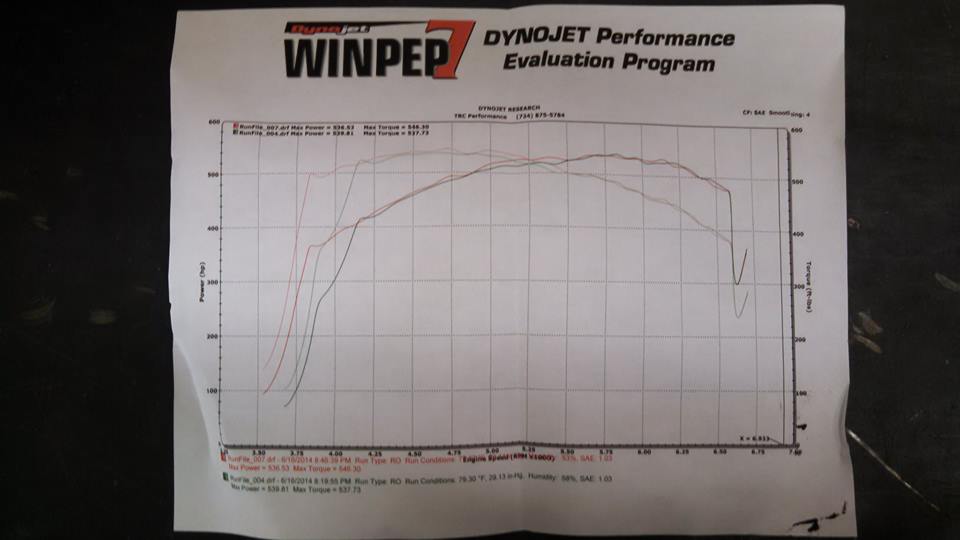

George C - do you have a pic of a dyno graph of your procharged truck that you could post?

this was when i dyno'd it with the stock catback with muffler added
when i swapped to the 4" exhaust i gained a couple more rpm and it smoothed the graph out some more and picked up more torque however i dont have a pic of that graph
cam is 218/218 570/570 112
swapped to the 4" and truck made 554 rwtq and went to 545 rwhp, my P1 is maxed out at this level
Attached Thumbnails WOT shift points on my set up-10356222_767648616618634_8507513004814792394_n.jpg
