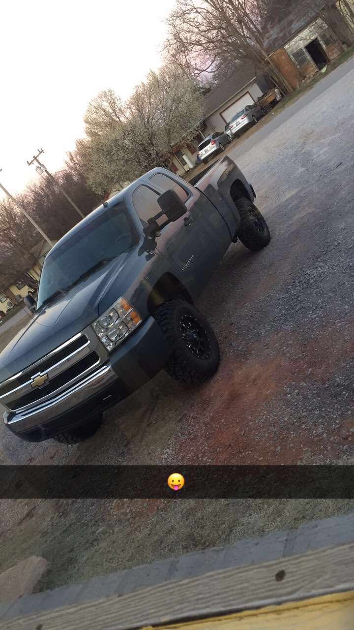

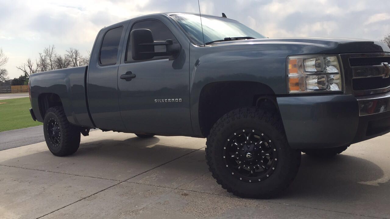

Hello i am new to the form. I have a newly modified 08 Silverado. I recently put a cam in it, put 410s in the rear with a Detroit Truetrac differential, upgraded my 4l60E and inserted a 3200 stall, and added longtube headers with y pipe. Now I'm wondering what all is needed to go forced induction. Mainly wanting a turbo. I know i need bigger fuel injectors and a new pump, but I'm only looking for a minimal amount of boost. So, do i need to get forged internals? any input would help.
