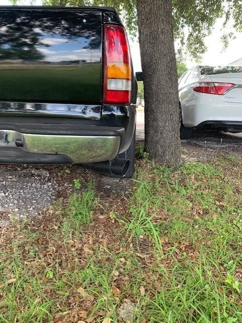

What's everyone's take on this for 4" exhaust?

Definitely not a straight swap affair but it's in.

little late to the party, but this is pretty much the same i did with mine. I grabbed the cheapest 4" straight pipe exhaust for a 2010+ duramax truck was like $250 iirc in stainless, magnaflow 4" straight thru mufflers a 30" and a 6", added a flex section.
wasnt a direct fit by any means but the over the axle section was pretty close, had to move all the hangers, i added in some vbands where it makes putting it all on and off easier.

mine doesn't look like it sticks out too much, i since have added my rear seat back and it did quiet down inside.

Finally got my kit on. Went together pretty easily, didn’t even have to cut anything. My tip don’t stick out neither.
