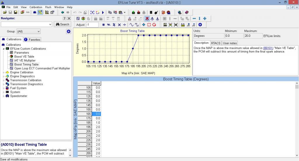

How are you setting the tune up so it pulls timing by manifold pressure? My timing table bottoms out at 1.20 g/cyl basically at any boost level so the last row of the table is my timing in boost. Is there a timing retard table based on manifold pressure?
I think you are conservative on your timing by the way.
EFI live boost timing table. It lets you pull timing based on boost levels.

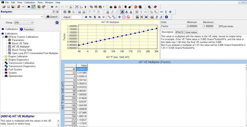

also EFI Live has a table i use to help with high IATs/hot starts. Once I got it dialed in, i have no issues...
