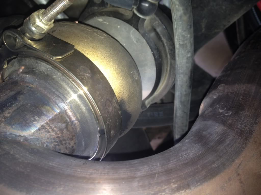

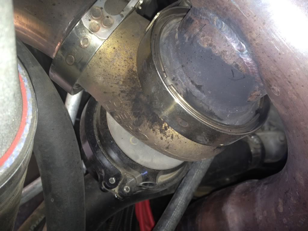

no wonder if these stains on WG have anything to do with it...i cant hear a leak

That's on the hot side pipes, if it leaked exhaust badly there you wold have less boost instead of more...maybe make the leak bigger

That just looks like moisture splattered out of the VBand clamp. Nothing to worry about IMO. Sounds like a boost controller or wastegate problem.... Maybe a restricted wastegate exhaust if everything else is working as it should.
