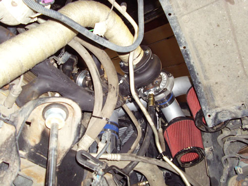

i used mild steel for my intake and exhaust sides - cheap and easy to work with
