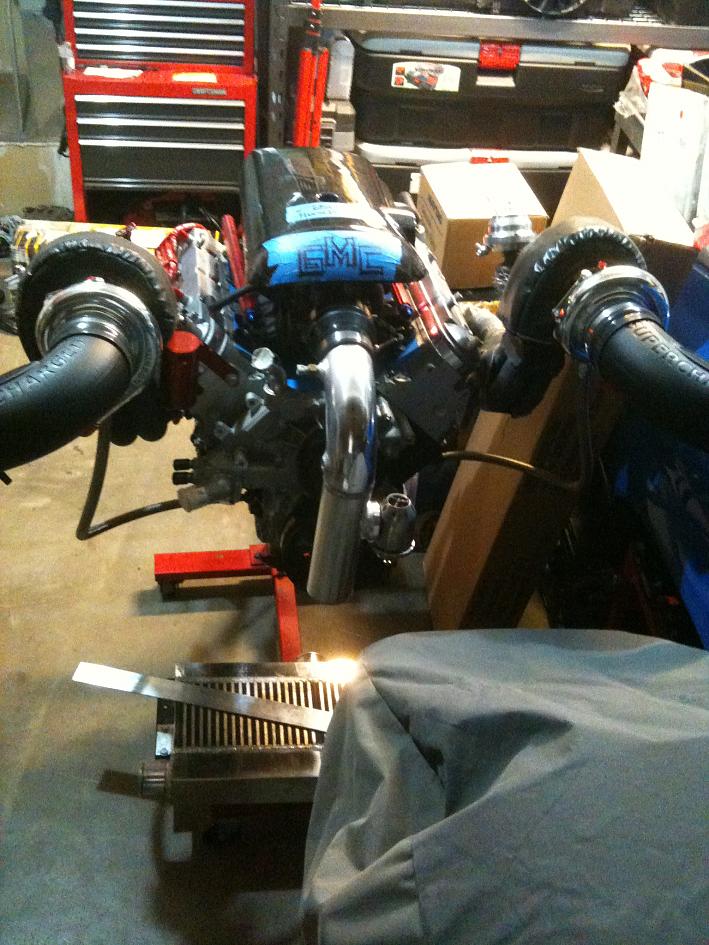

Keep posting this pic... I'm going to run twin Turbonetic 60-1's on a 5.3 with 317's and a Senergy turbo cam.

^^^I like that, what are you expecting and what is the A/R on your turbos. I also have turbonetics. 2004SSS, come on man that's not fair!!! hahaha. A little bigger!! Wanna trade?

They are p trim turbines. I have two sets of turbine housings. One set came with the turbo's which is .96 and the other ones I have which I'm going to use are .81. Both are way to big for my 5.3. I'm trying to get ahold of either .58 or .68.

What do you think you'll run, return style or non return style? Are you going to be using a boost controller?

chevybowtie, that sounds like a nice combo. What are you expecting power wise? .81's are big, but man it sounds fun..
