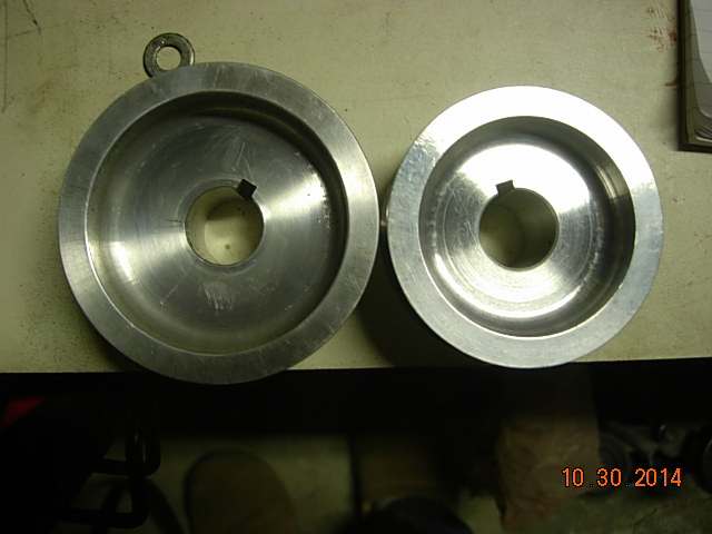

this is the old 3.10 and the new 2.65

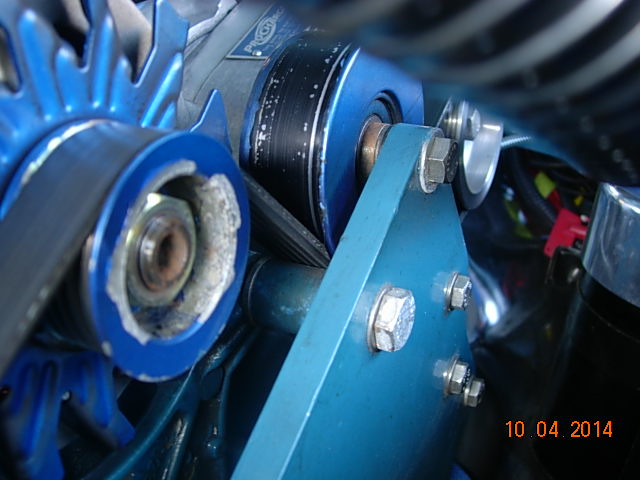

here is the old setupName:  DSCN9715.jpg

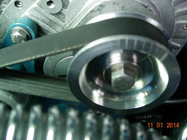

this is one of my original modifications to prevent slippage

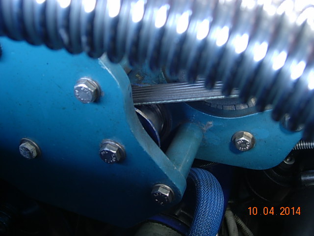

this is the original idler...too closeName:  DSCN9718.jpg

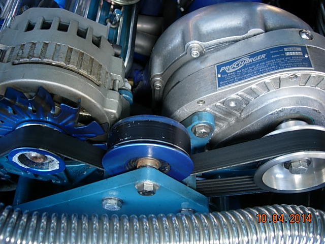

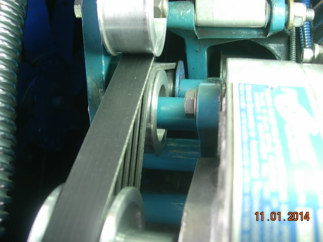

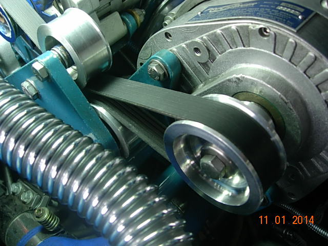

my new set upName:  DSCN9766.jpg
this is the back side of the bracket ..2 idlers direct the belt to the power steering
I had to go with a shorter belt to 109"...but that have something to do with the dual alternator setup I added, also

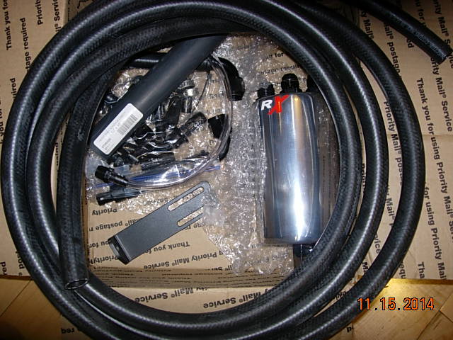

monster catch can came today...
