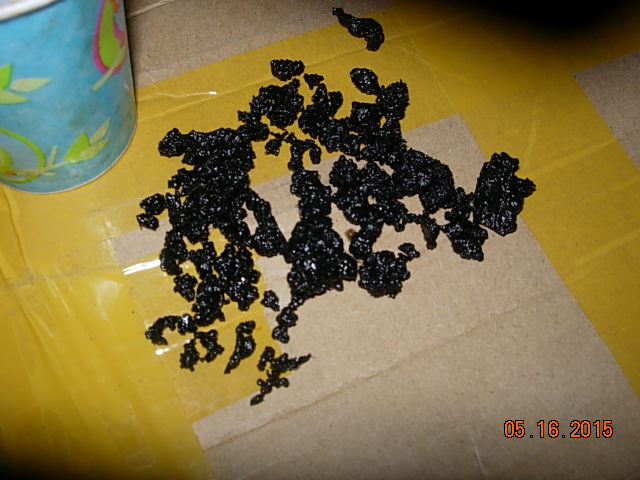

after the catch can install I decided to clean my piping and intercooler..i found this in the inlet....looks like tar but not sticky , smalls like gas and is rubbery....any ideas

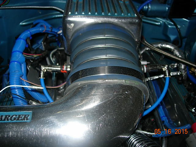

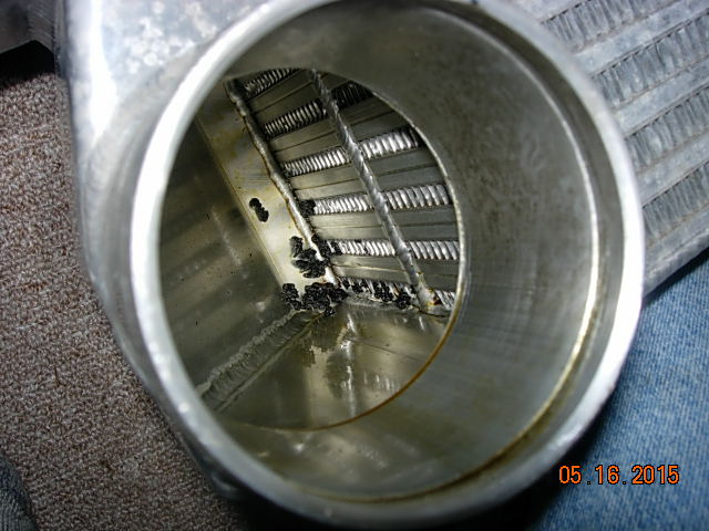

this is the inlet side

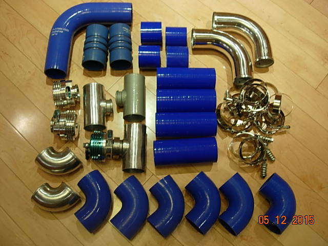

this is some of the new piping I am going to put on

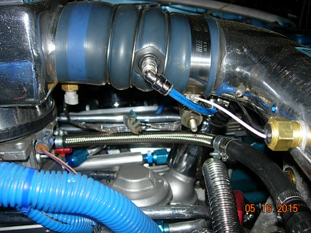

including dual nozzle upgrade and dual iat's

Old dried up oil is my guess.

there is nothing, but oil on inside the exit on the intercooler, but could be blocking tubes...going to rinse with simple green and alcohol

That's crazy looking.... Was your intercooler and piping shipped in styrofoam peanuts? If so you may have not gotten them all out, and they turned into black crud?!

did a cleanout today with a gallon of seafoam and heet to finish rinse...5 rinses to get it to run clean...a lot crap came out
