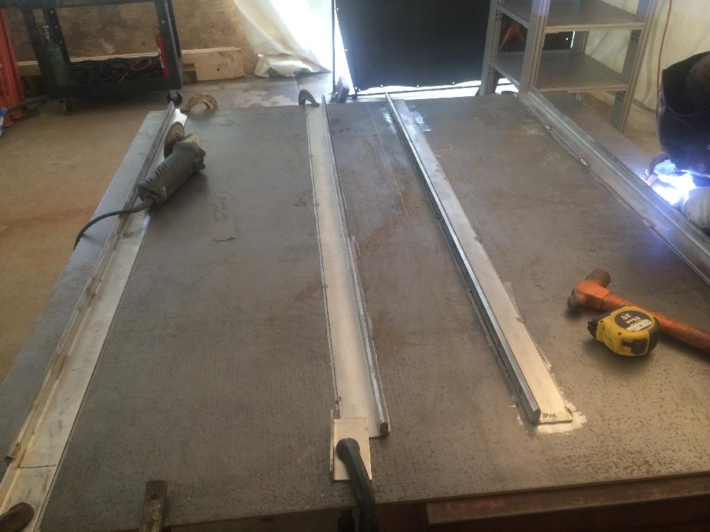

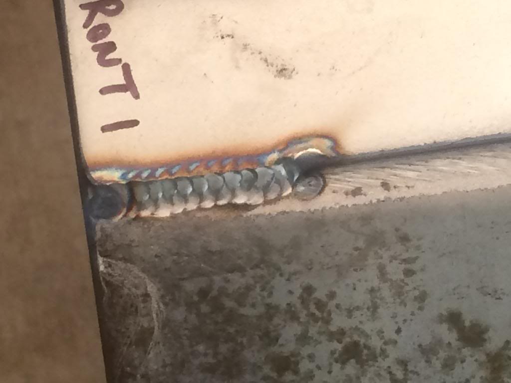

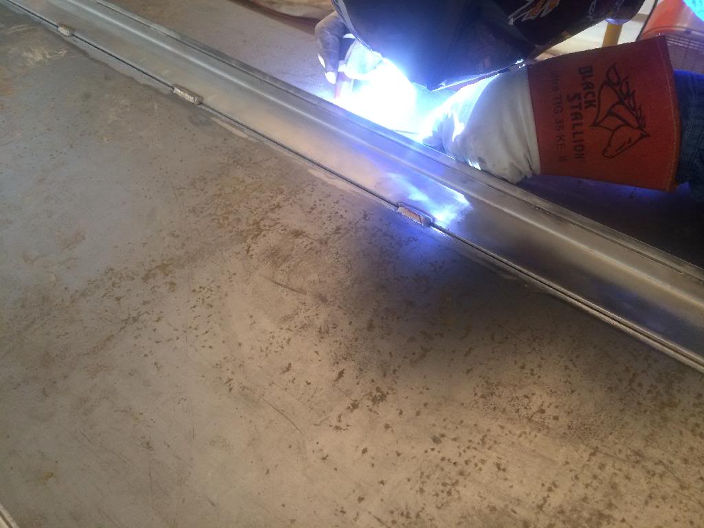

Here is a table we are building at work for equipment racks to slide back and forth on with rollers . The the rails are carbon steel , welded to 316 stainless , which us welded to carbon steel plate . All work was done with TIG/ 316 filler ( that's what we have ) and it all is forever , no problems at all with the dissimilar metals
