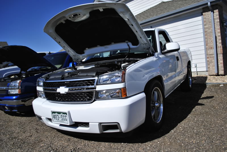

Im running a W2A setup and love it, also selling my current core assy if your interested, its a direct bolt in for the right front corner of our truck. I've ran it with a blower and a turbo setup, keeps intake temps real low at the track if iced down!
