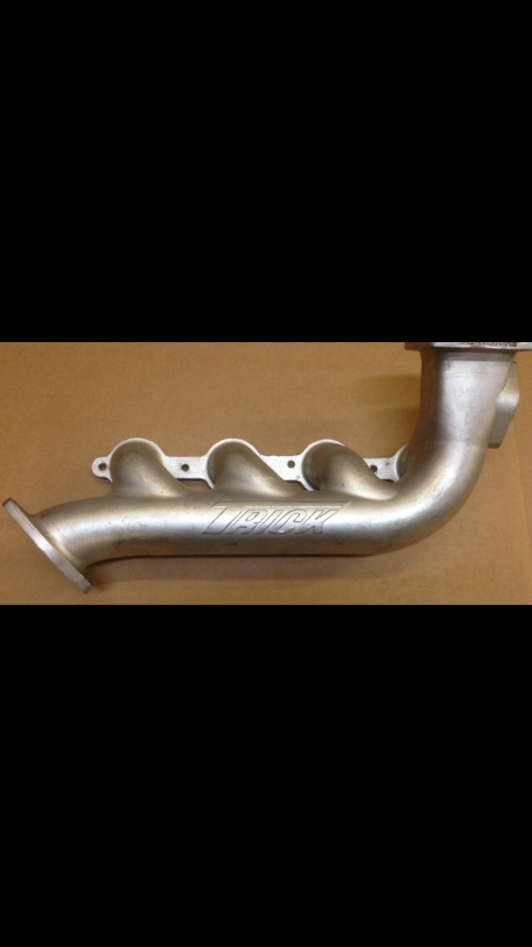

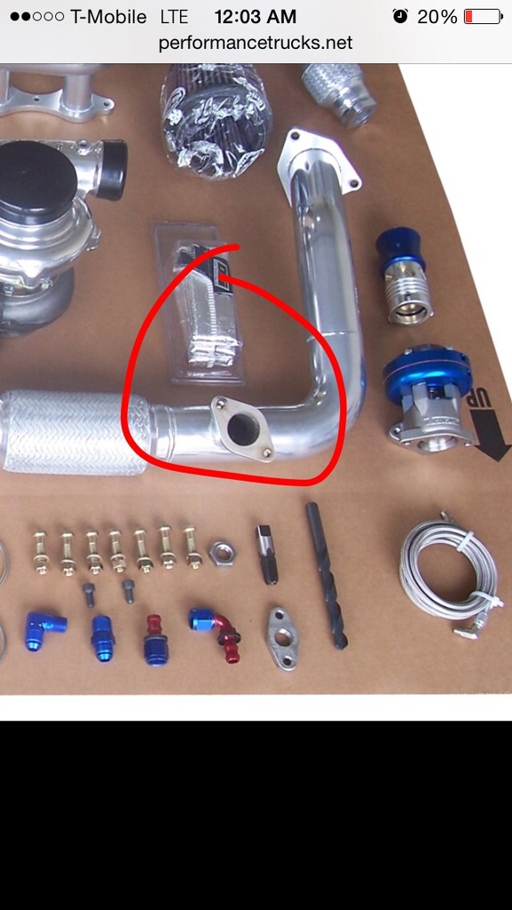

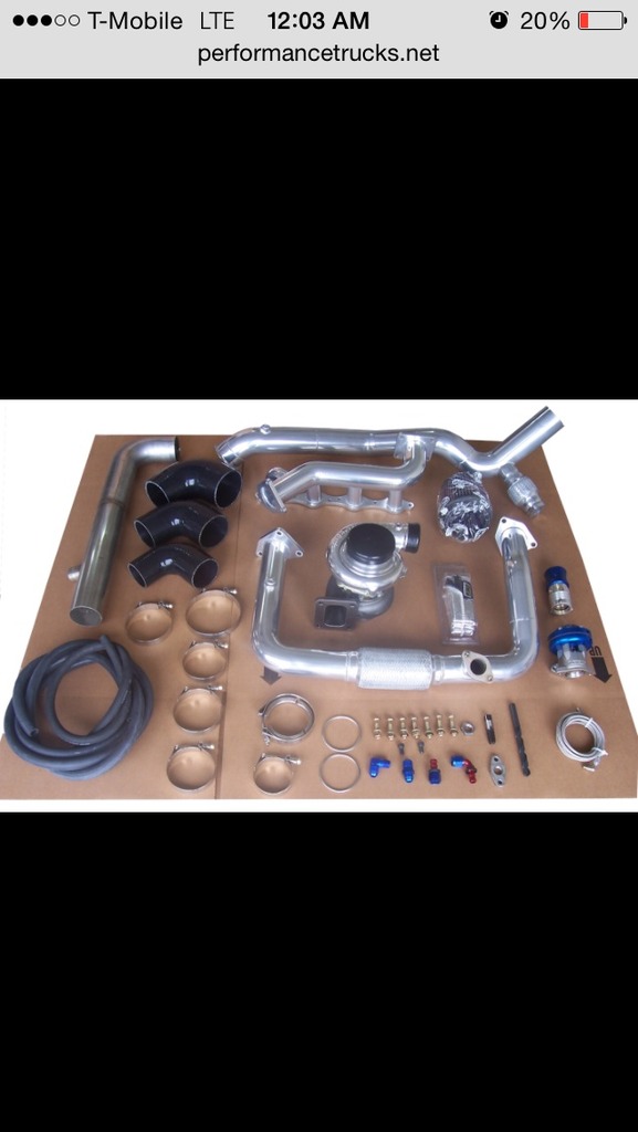

Hi there, I was wondering if anyone runs a wastegate on their turbo cross over pipe. I'm looking for a place to weld in my wastegate and so far, the cross over pipe would be the easiest, but I'm not sure how effective it would be considering it's not catching/routing the exhaust gas from the other side of the engine. I found this kit on the forum, and I was planning on fabbing the wastegate the same way. So my question is does this method work? How Well? Any input would be greatly appreciatedName:  image_7.jpg

Yes, It works just fine. Myself and Trick have built hundreds, if not thousands of these type setups. Only ever been very few issues with boost control and I attribute most of those to other factors.
Old Jun 15, 2015 | 09:32 AM
Atomic's Avatar
I have a gauge for that
Posts: 16,282
Likes: 438
Works fine for your typical 70-80mm turbo setup on a typical 5.3-6L engine. With a bigger turbo or bigger engine you may want a second gate somewhere.
WOW that's an old picture. That's from
I would say 1000's.
That location has been been used for 10years or better.
Works good on all applications as long as the gate is matched to engine/boost/power range.
Exp. 39mm gate on a 427 trying to run 5psi not happening.
Like mentioned I only know of a couple that boost control issues.
Swap to a larger gate problem solved.

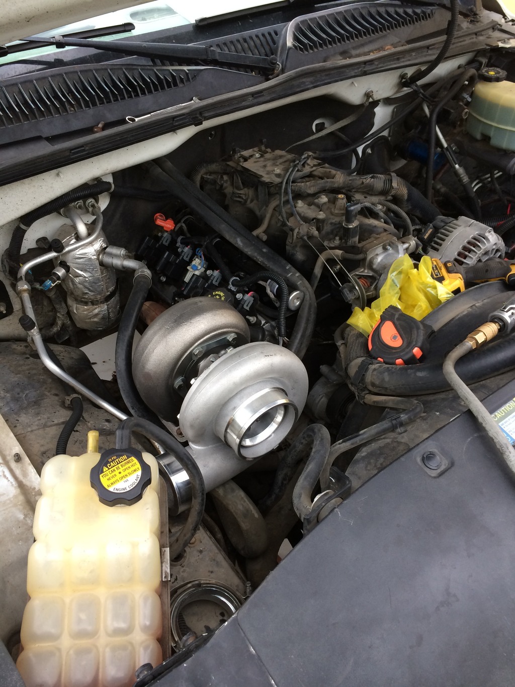

I've got a 6.0 lq4. I'm running a cheap ebay turbo
http://m.ebay.com/itm/190592393465?txnId=1134354469009
