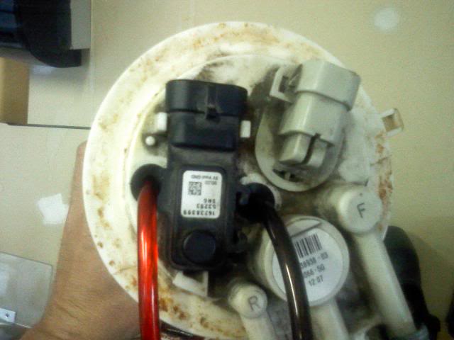

Sorry, this is the only pic that turned out ok on my phone. The wires go through the grommets and are attached directly to the pump via ring terminals. The ground wire gets grounded using the same bolt that grounds the filler neck. The power wire runs along the frame in a wire loom directly to the relay in the fuse box.

phasemaster1's Avatar
Joined: Aug 2005
Posts: 1,416
From: florida
FUG those wires are big compared to stock. Wires tight going threw the grommets?
Yeah, they were really tight. We used some gasket maker around the grommets before we put the tank bank up, just to make sure nothing could get in.
holy ****, is that 8 gauge?

Acc. to 1st post, it's 10 ga.
It's 10 gauge wire. The coating on the wires is thick, very high quality.

What kind of wire is that? It looks like speaker wire from the pic. Also is it gas proof?
No, they aren't speaker wires. They are ok to be in gas, oil, etc.

Thanks for the info, but where did you get the grommets from, and what size are they??
