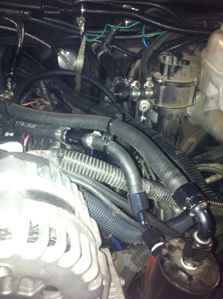

Originally Posted by Ferocity02
I use the stock PCV system with a check valve and catch can inline. The check valve prevents the boost in the intake from going through the PCV lines into the crankcase.
And then I run a single 3/8" line from the passenger side valve cover to the turbo inlet pipe.
I was worried that the single 3/8" line wouldn't be enough to vent the crankcase while in boost, but it seems to be working fine. I've never pushed out the dipstick. I may upsize the line anyways and plumb it from the oil filler cap to the turbo inlet.
im gonna do the same setup as this looks easy and cheap
I did the same thing. Works great for me.
Here is the check vale i used
Check Valves
Catch can

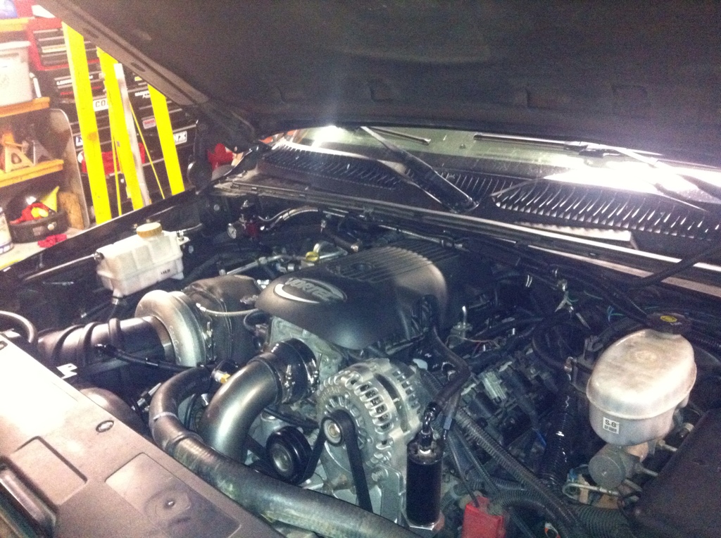

Fresh air side hooked in pre turbo I had another check vale there originally but i removed it after being told it was bad idea. Which it was a bad idea.

hard to see but does the line off the turbo go to the bottom fitting of the catch can? then top fitting goes to motor?

Corey, why no AN fittings on the check valve?? Looks a little out of place....
It goes to the passenger side valve cover. Just like stock.
The check valve only came in barb style fitting . Yeah it is depressing.
