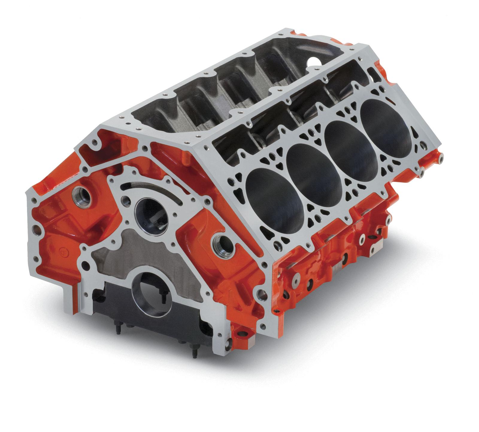

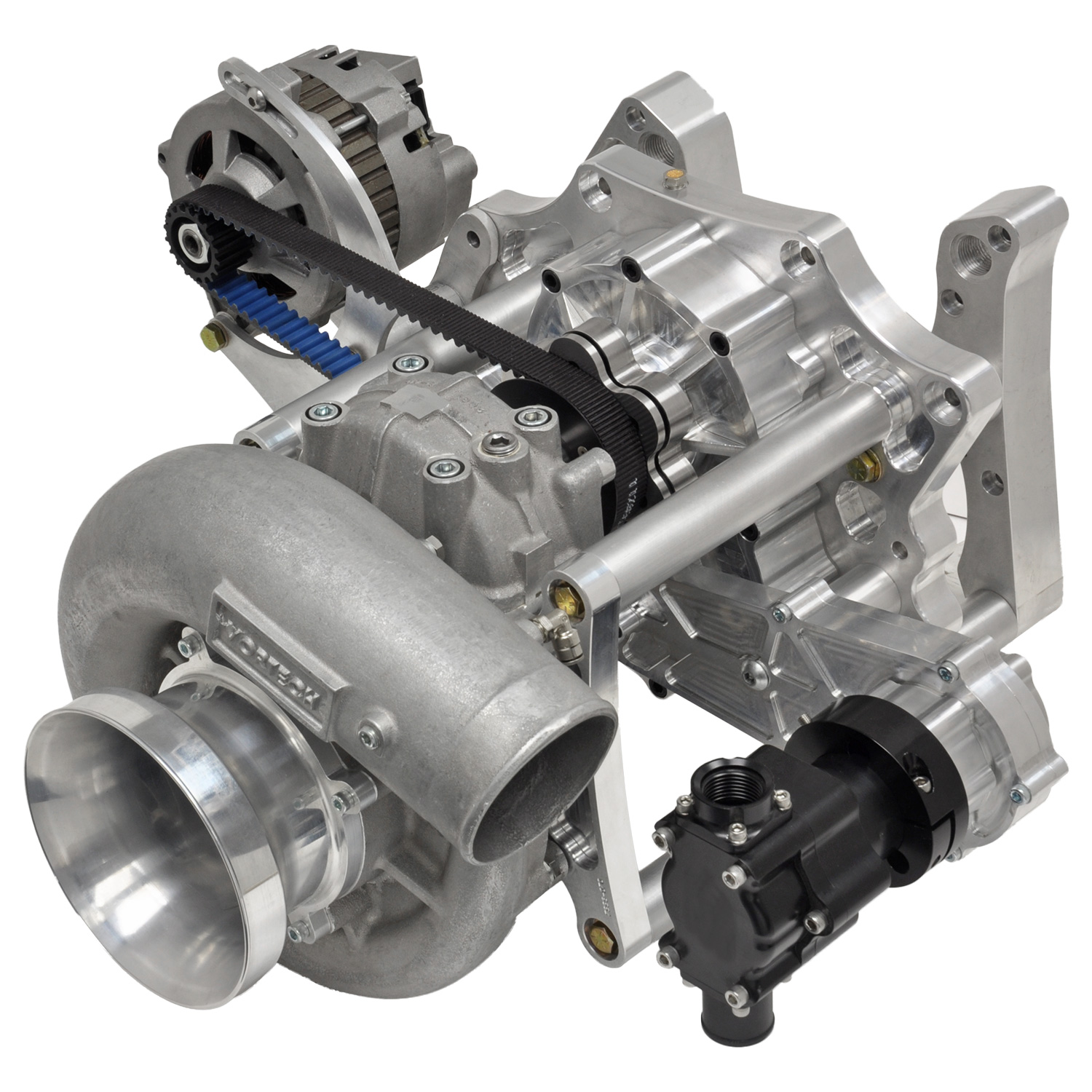

Hi, been reading your build section. I really am not up to this, wow. So much I have no idea about. Way over my head, heheh. But I'm not a quitter , so I will go ahead with vengeance . I noticed you referenced the weight of your pickup as about 3700-3800 lbs. I have got mine down to 3380 without me in it. I was 280 until my surgery now I'm down to your size. Of course I have really stripped the pickup big time. Its GUTTED. And we figure it will be 3100 ( maybe a little less ) after tube frame. I found that good deal on the LSX block so that is a step forward too. A 427 is what I've always been wanting. Pro Systems said I could be 9.5 to 1 comp. My engine builder suggest 8.5 to 1. What have you had your compression at ? I will be picking your brain if that's ok. I am going with air to air intercooler, that will be one difference. and of course you have the F2 and mine is a bit smaller F1X. I'm running a Power glide also. Just got my converter back from PTC It should be stalled around 3500, and redone for the pro charger. I'm dead in the water till I get back to work. No paycheck = no parts. Also maxed at the bank. Getting all new for the engine except cam, it only has 2 runs on it. and should be spec'd good for the F1X. don't know why pics don't come up
Attached Thumbnails Update , long over due-nal-19260093_jy_xl.jpg   Update , long over due-cds_acc-drive_assembled_str.jpg
