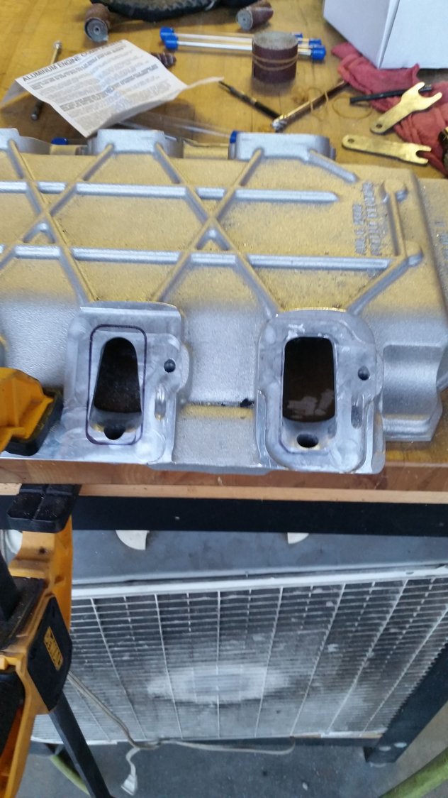

Old 10-05-2016, 08:44 AM
shaw_426hemi's Avatar
Join Date: Jan 2012
Location: Minnesota
Posts: 401
Received 0 Likes on 0 Posts
Got started on the pirt matching of the lower blower manifold. Slow process, should be worth it tho.
