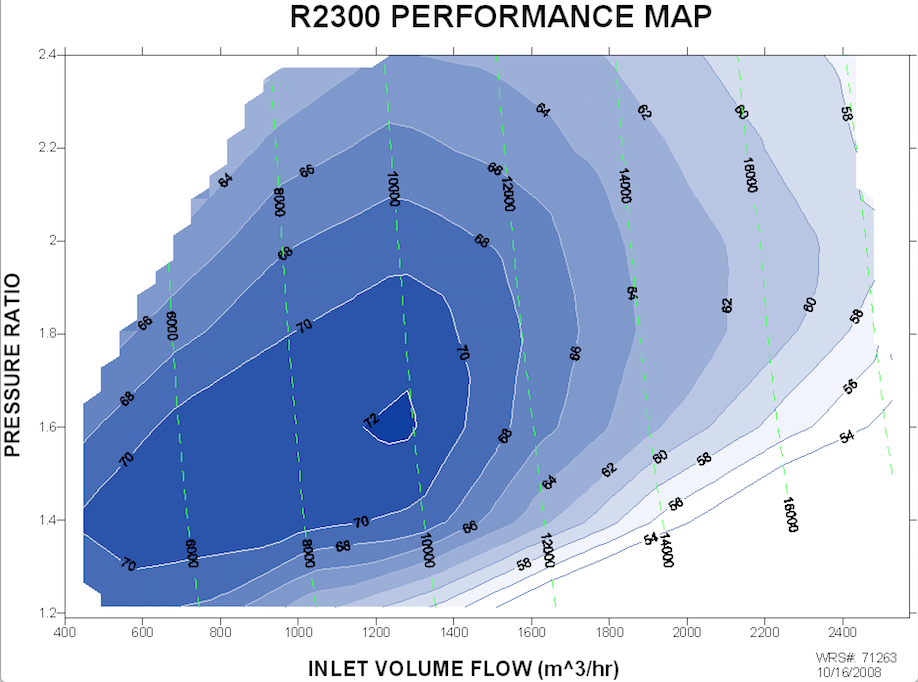

that's also consistent with Magnuson & Whipple engineers' build advice over the years of "use the smallest blower tempered by the efficiency of the CFM needed for your goals". comparing the map above with the 2300 below using my car's specs (because i can reference them a little quicker), we can see that turning 6000rpm spins the blower to 15k & produces ~1.8 pressure ratio. that equates to roughly 2050m³/hr @ 63% efficiency. follow the chart in the opposite direction to see that moving equivalent air through a 1900 would be interpolated off the right edge of the map to a little over 18000rpm @ 58% efficiency. that just means more heat & belt slip to combat along with potentially accelerated bearing damage due to the higher belt tensions & impeller speeds.

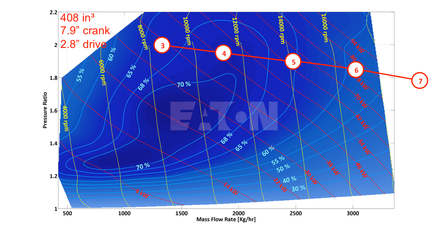

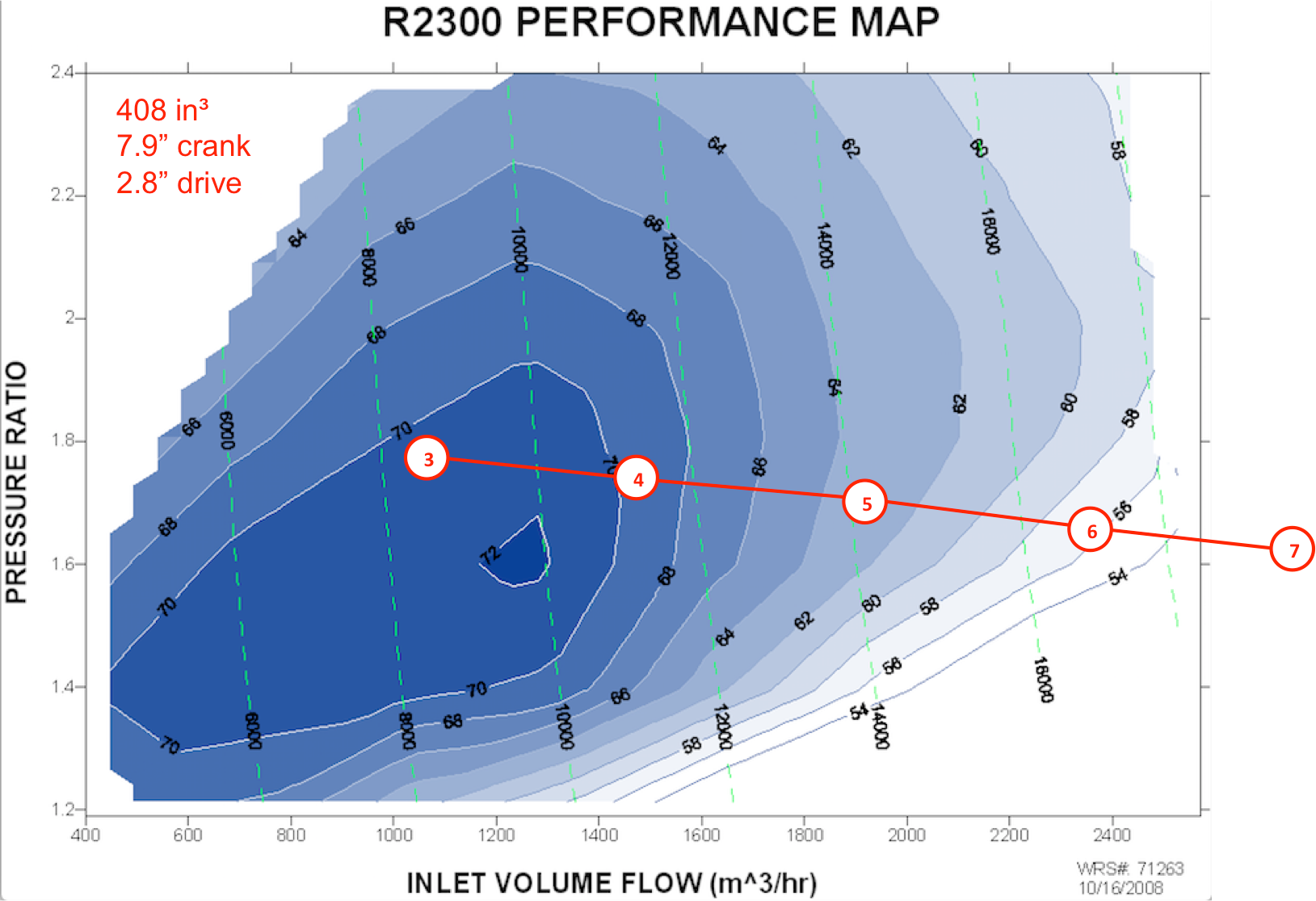

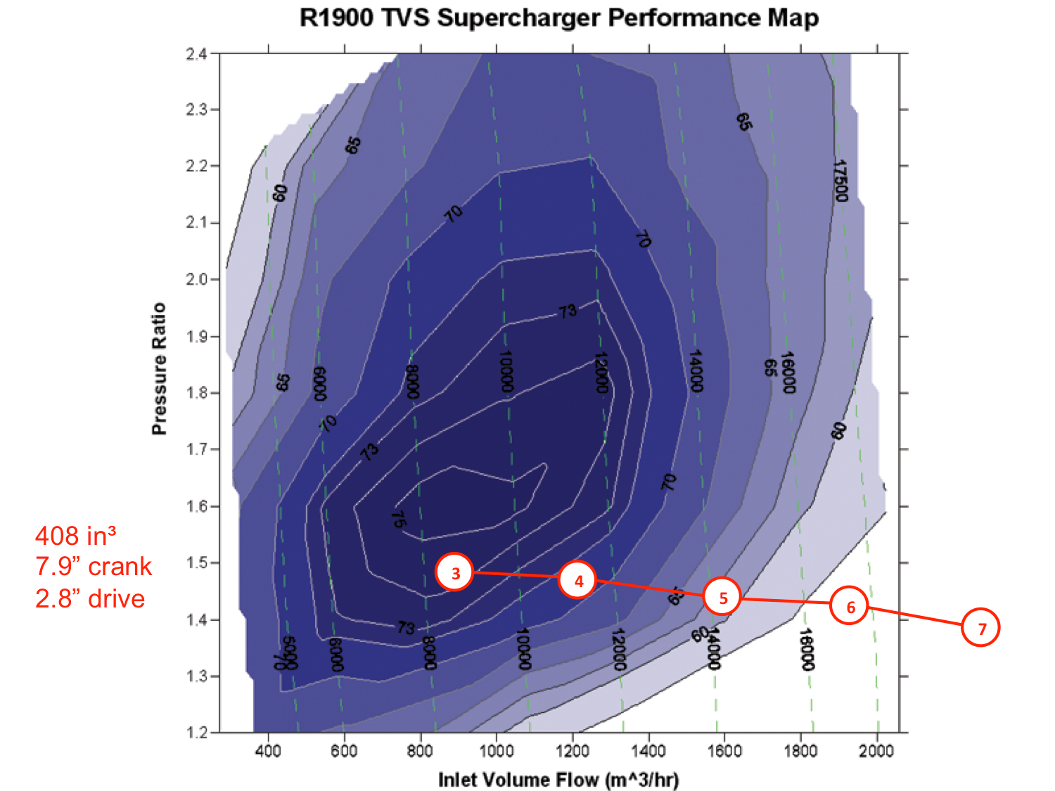

so after taking a play from OnStar's book & digging through your truck's personal data, it looks like you've got the direct drive TVS1900 (top-mount, non-jackshaft unit with the intercooler brick under the rotor pack) being spun by a 10% OD balancer & a 2.8" pulley.
i went through & plotted the blower speeds in relation to each 1000 engine rpm (red circles) on a street pull, and here's what the math says your blower'd be doing if you simply transferred it as-is to a 408 (7.5psi falling to 7psi):
now if you were to put those same pulleys on a TVS2300 with that 408, here's what you'd get (12psi falling to 11psi):
and finally, a TVS2650 runs 16psi down to 15.5psi

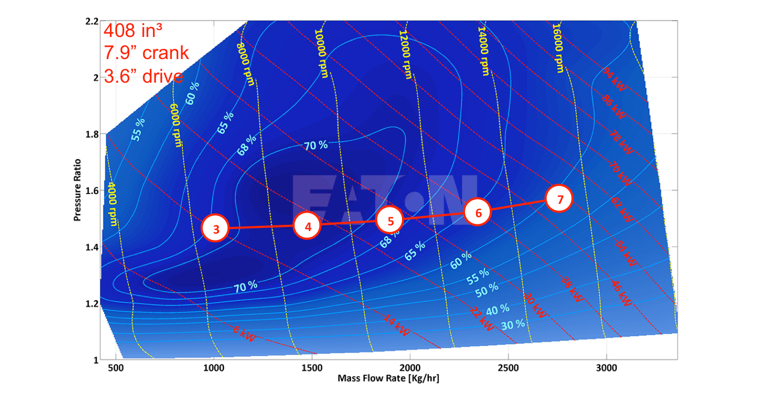

and now the apples:apples visualization of my original statement - if you run a 3.6 snout pulley on the 2650 to achieve the same-ish pressure ratio as what the 1900 made on the 2.8, you get this (and it rises from 7psi to 10psi by the end of the pull):
**disclaimer: the maps of each unit design are slightly different - even when using the same rotor groups - and i ain't got no clue which specific design each of these maps correspond to... however, they'll be close enough to make an informed guess. also, this assumes you've mitigated any belt slip.

and since i never thunk to actually plot this out before, here's what my car's doing right now:
