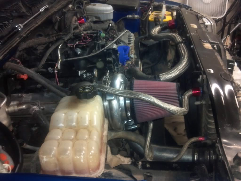

you could run a front mount , or a rear mount. a frount mount you would use a stock manifoild, and a custom flipped log to mount the turbo and have a cross over pipe. then run your down pipe and exhaust down your passengers side.

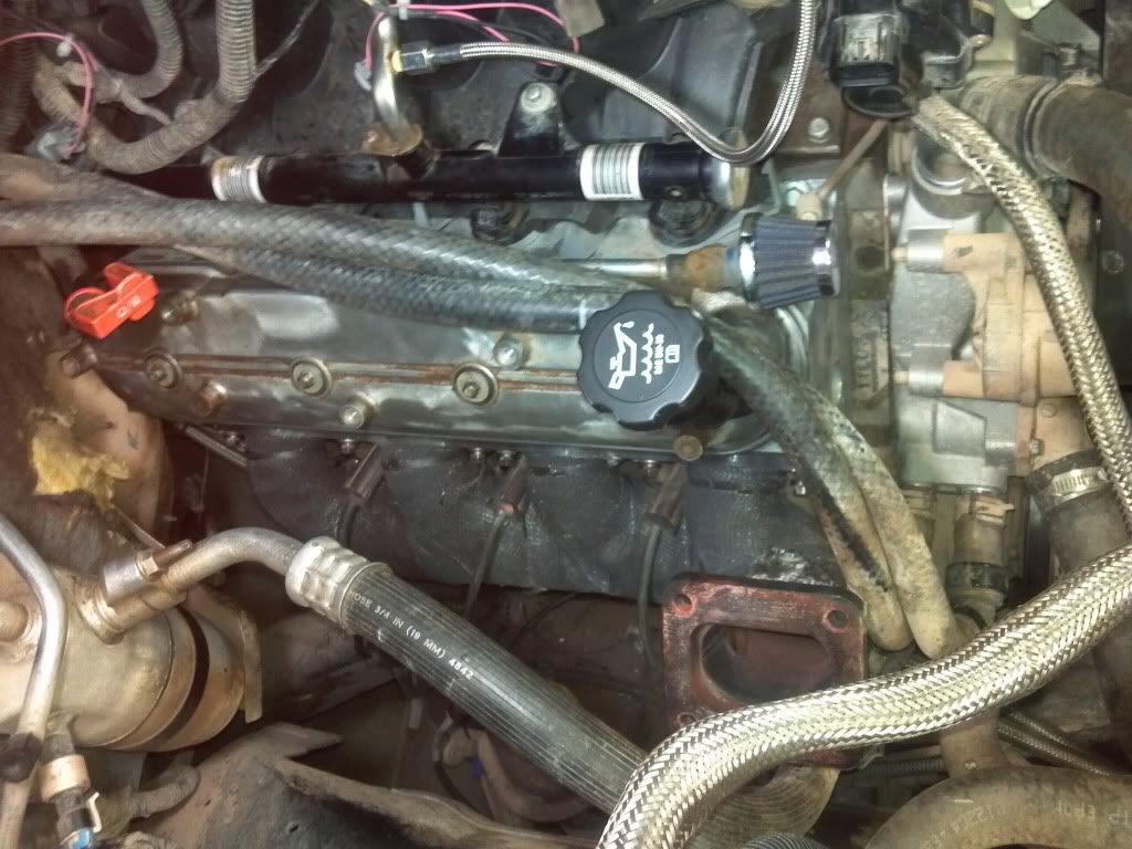

all i got is this for a picture for now off mine. i got a 2004 tho but same set up more or less.
