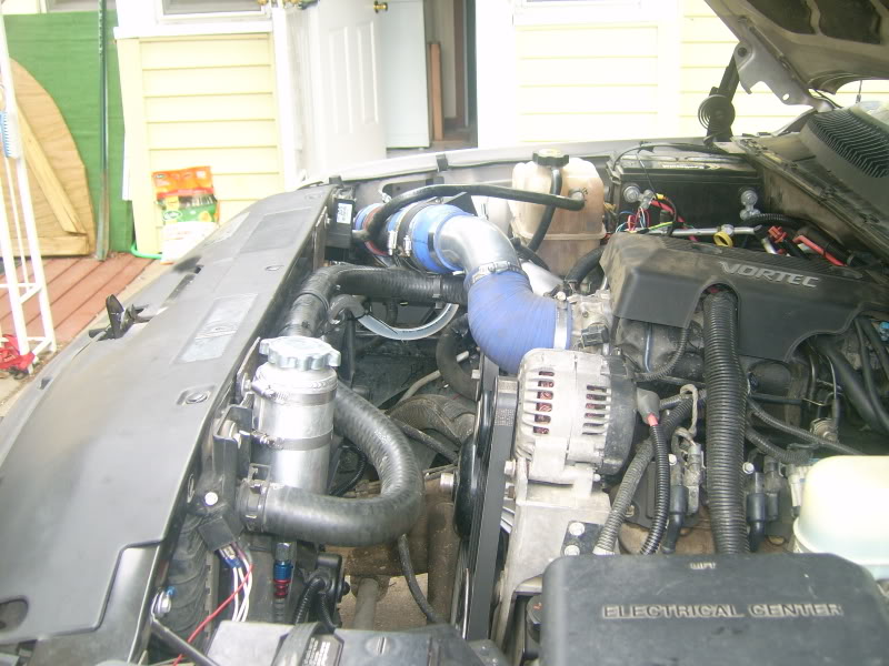

Here is how i had my MAF when i had the rear mount..
It wasnt long before i went ahead just did a Speed Density tune.
