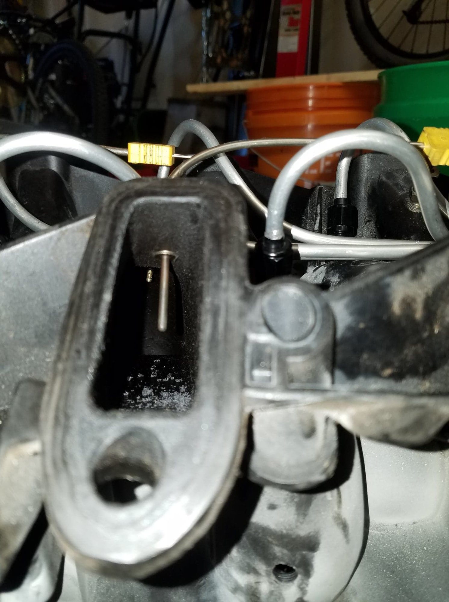

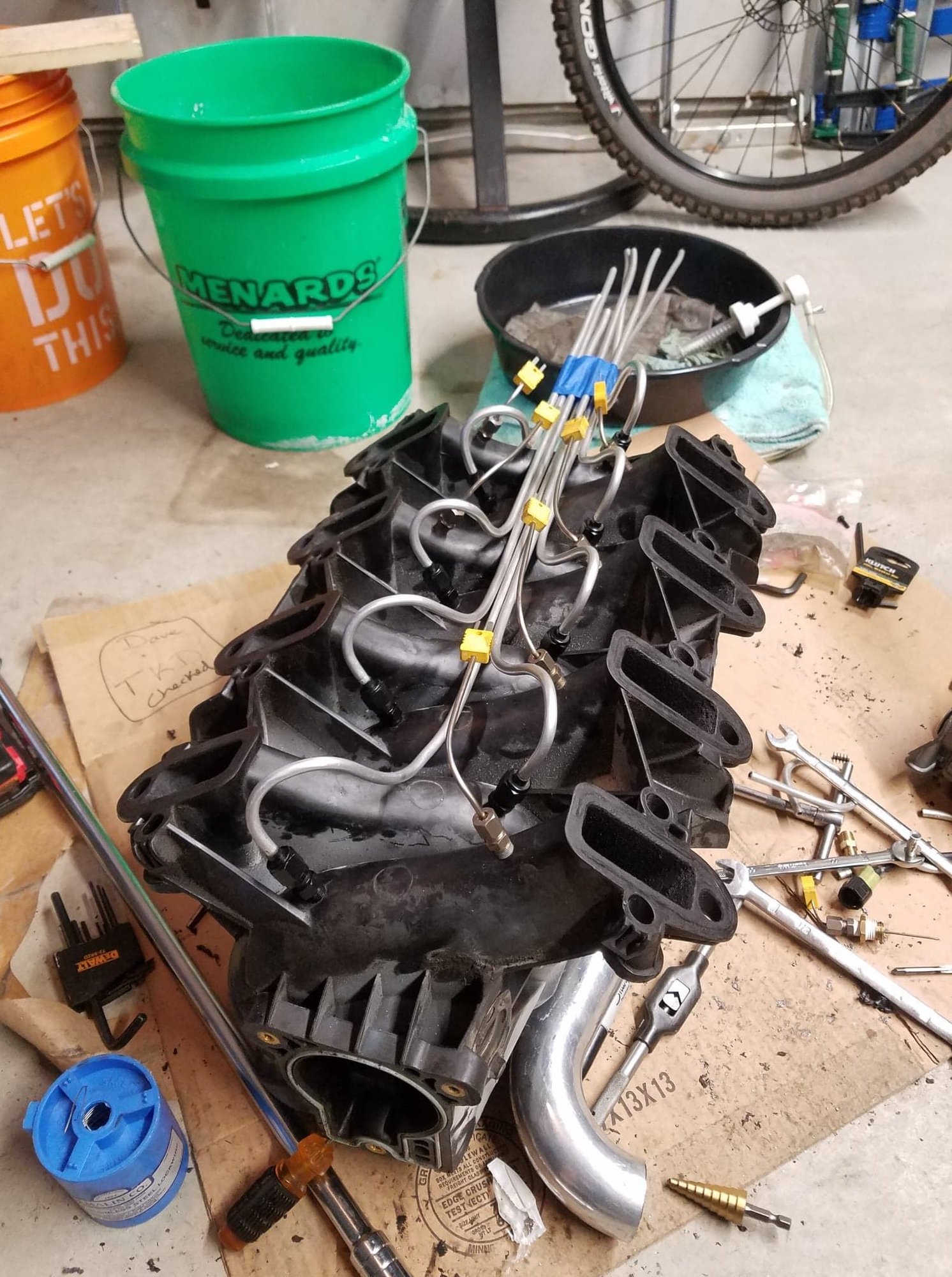

Well, it's not the interior pics I promised. But, I moved all of the water meth nozzles to the underside of the manifold. I only got it about half done but wanted to keep this up to date, ish. Next steps are to run the rear 4 cylinder hard lines and design a manifold to connect them all together.
The carb jets threaded into tapped AN to NPT adapters should allow me to dial in things a bit better for each cylinder. I decided to stray away from the individual check valves and put the check valve elsewhere.

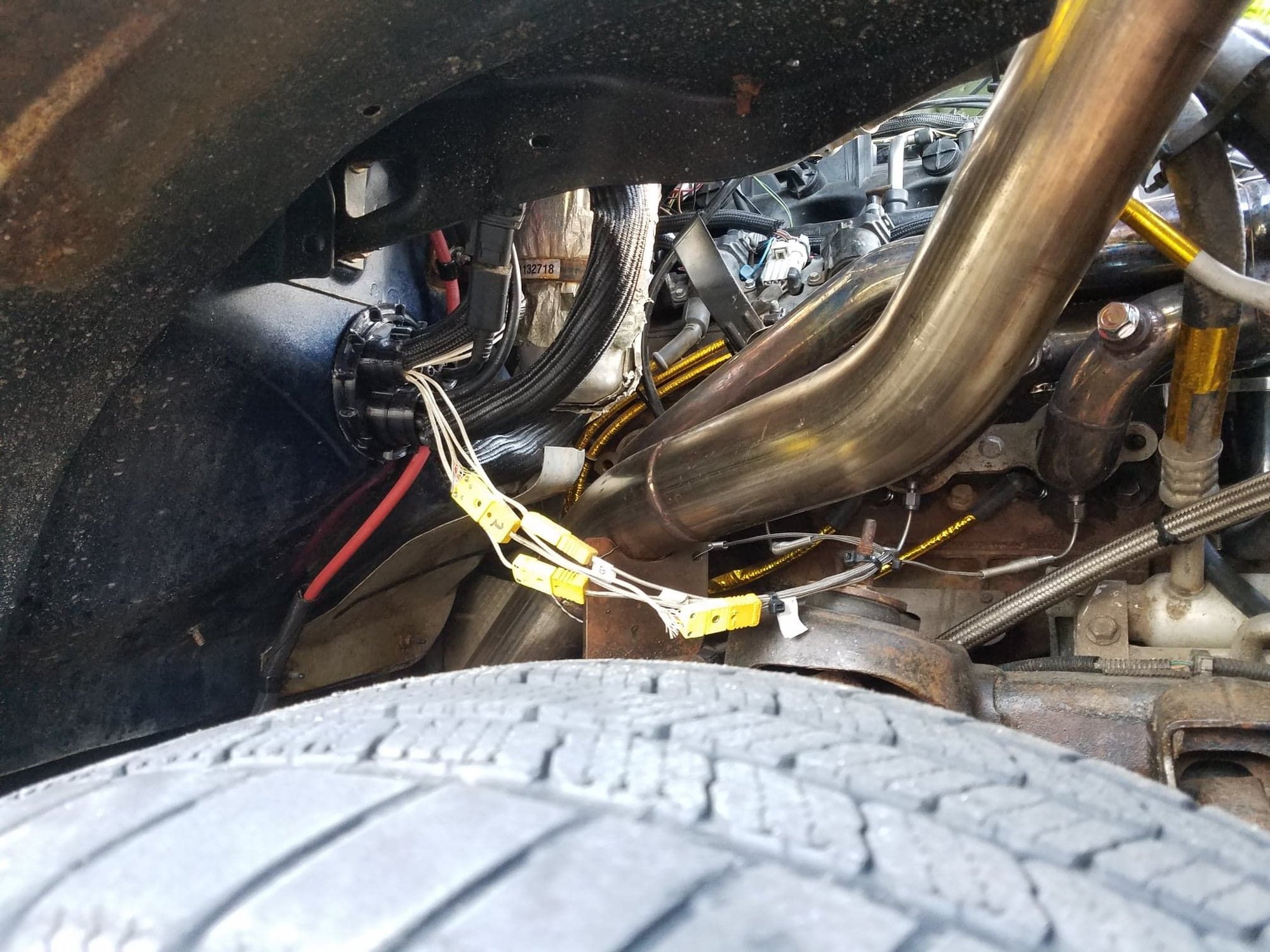

Half way to being one of the fanciest stock truck manifolds on the planet...Still have to drill and install the two remaining thermocouples when they arrive and build and connect a water-meth manifold to the lines. I might also try to get runner pressure taps on the underside of the manifold, I'm just not entirely sure how useful it will be at this point as there are widebands on each cylinder for charge bias detection. I'll think on it a little bit more, but in the meantime, here's two more pictures.
Thermocouple (front) and methanol injection nozzle (rear)
Manifold underside with WM and thermocouples installed. Didn't have enough thermocouples to complete it, but ordered more now

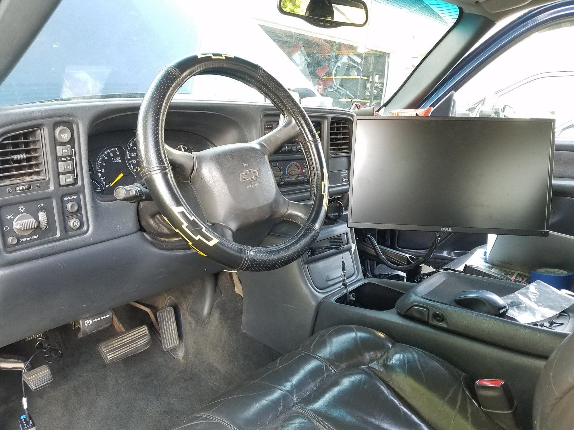

This is the cockpit as I've got it currently set up. Still trying to figure out if I want the computer to sit a little bit recessed in the dash or flush behind the bezel I printed out. All of the wiring and power supplies are routed through the center console. Inverter is in the center storage area and has holes cut for the wires in the bucket to keep the space semi-usable. I have to get rid of that steering wheel cover too...
This ended up being a safe location for the firewall grommet to go through. No surprise electical cuts and it ended up right below the blower motor and cover so it hides very nicely. I'll have to redo a couple thermocouple extensions to get them to the data box inside.
