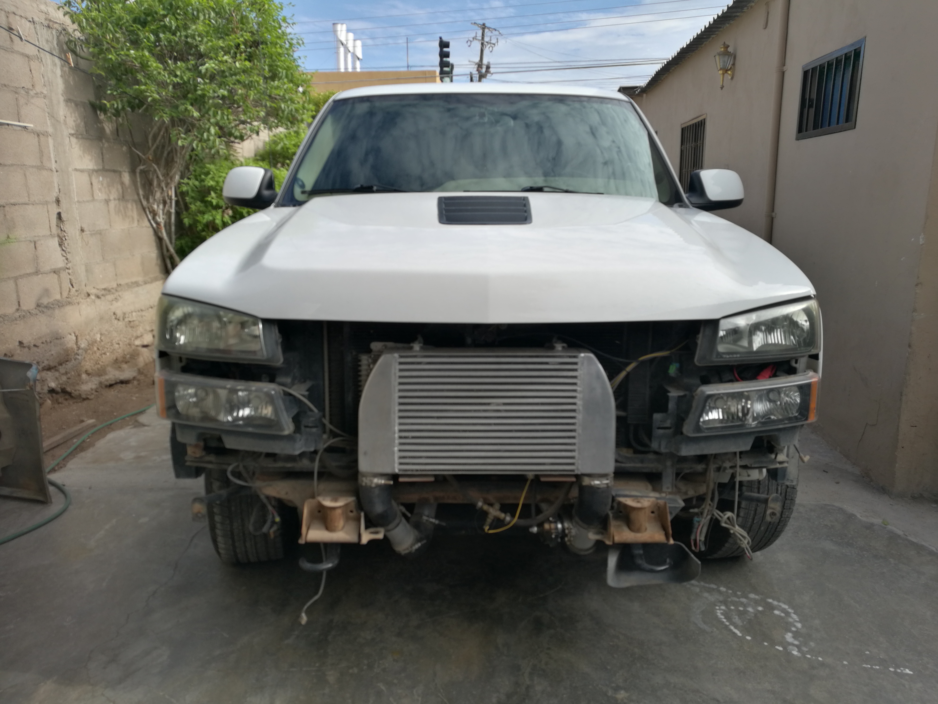

Originally Posted by TrickTurbo
Which inter cooler are you running?
That 4" intercooler you sold me
Better then the stock 3" for sure.
You really haven't started pushing that turbo @14psi.
If air temps are in control id turn the wick up prior to jumping to a larger turbo.
Going that route will need a larger down pipe as well as larger air filter, oil inlet fitting, and the discharge silicone could be different.
