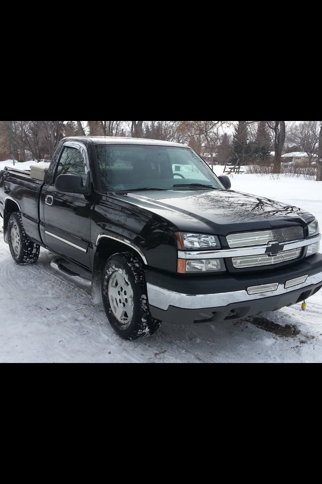

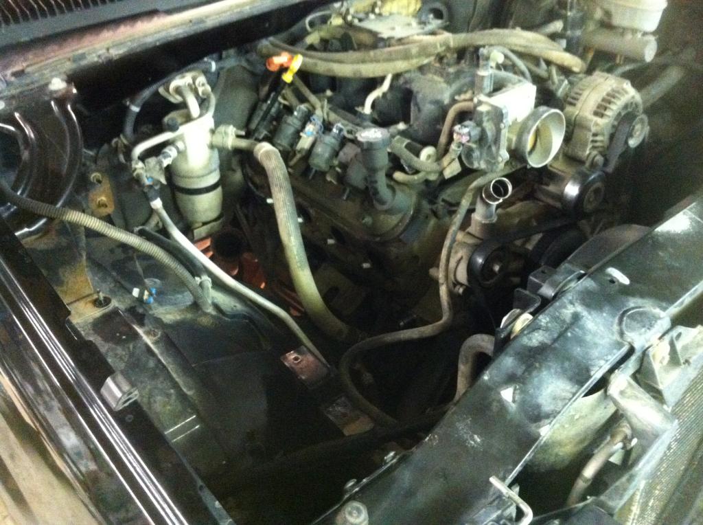

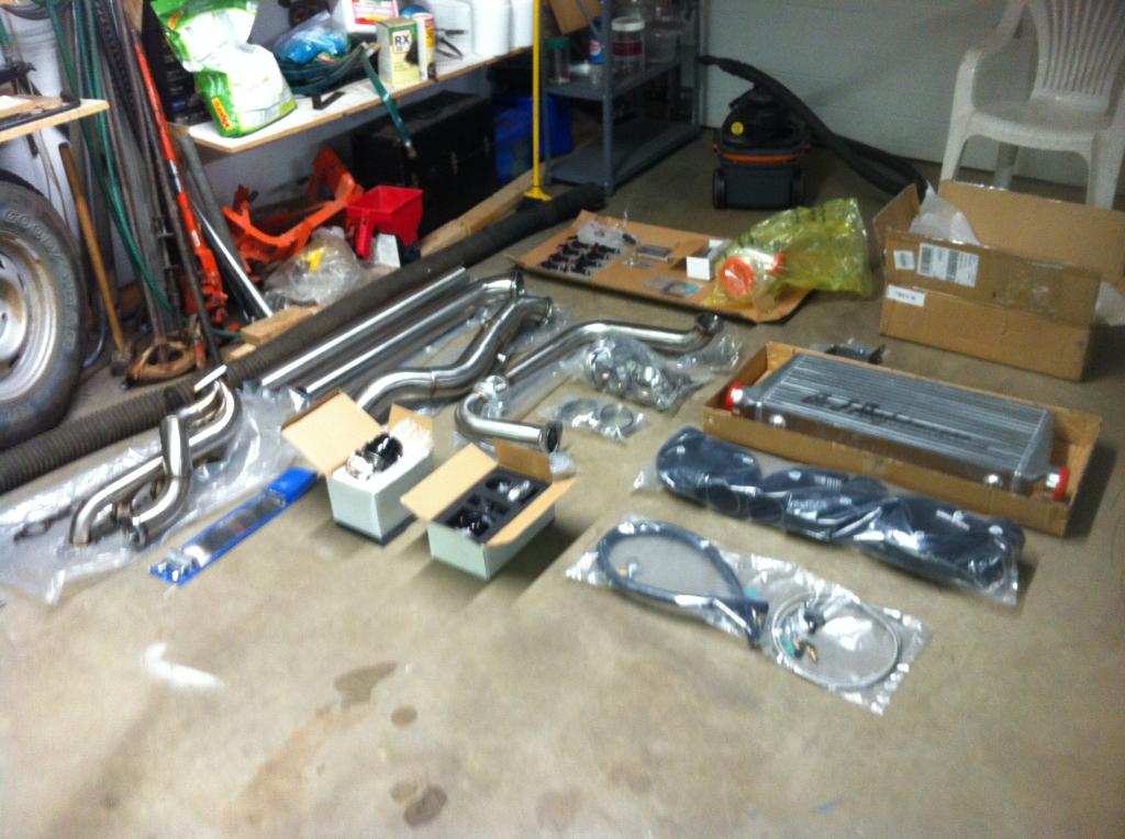

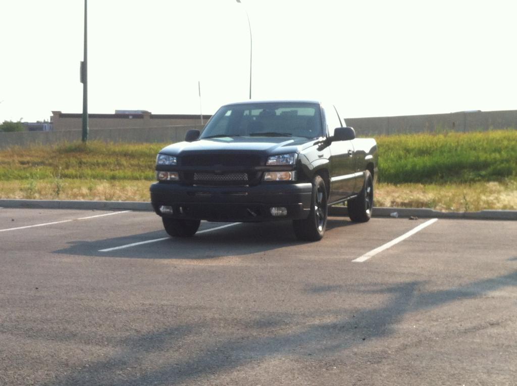

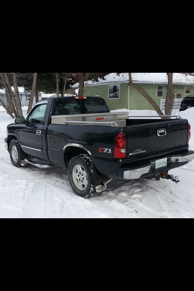

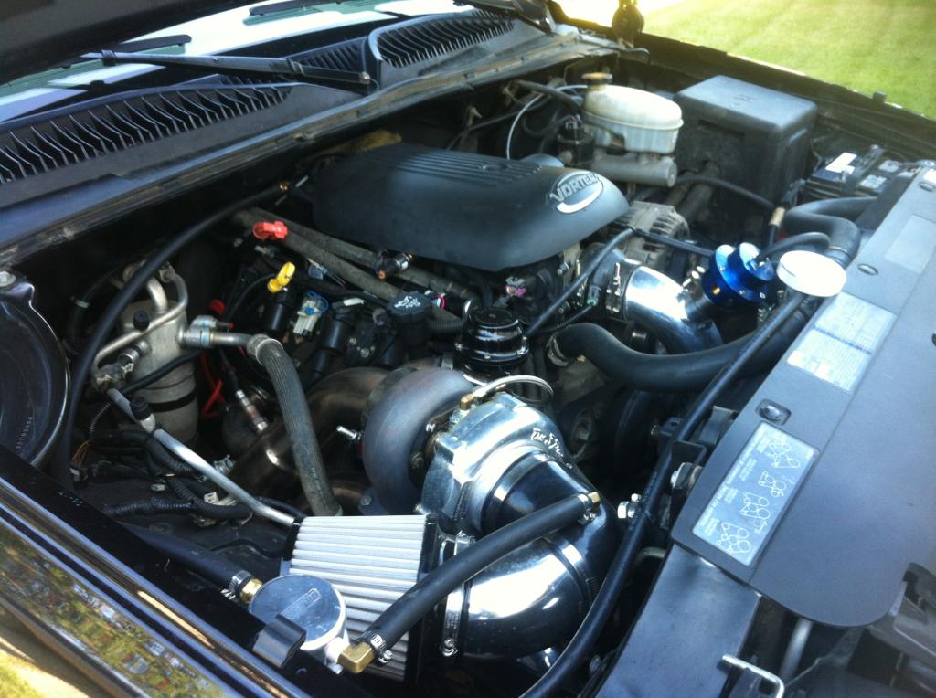

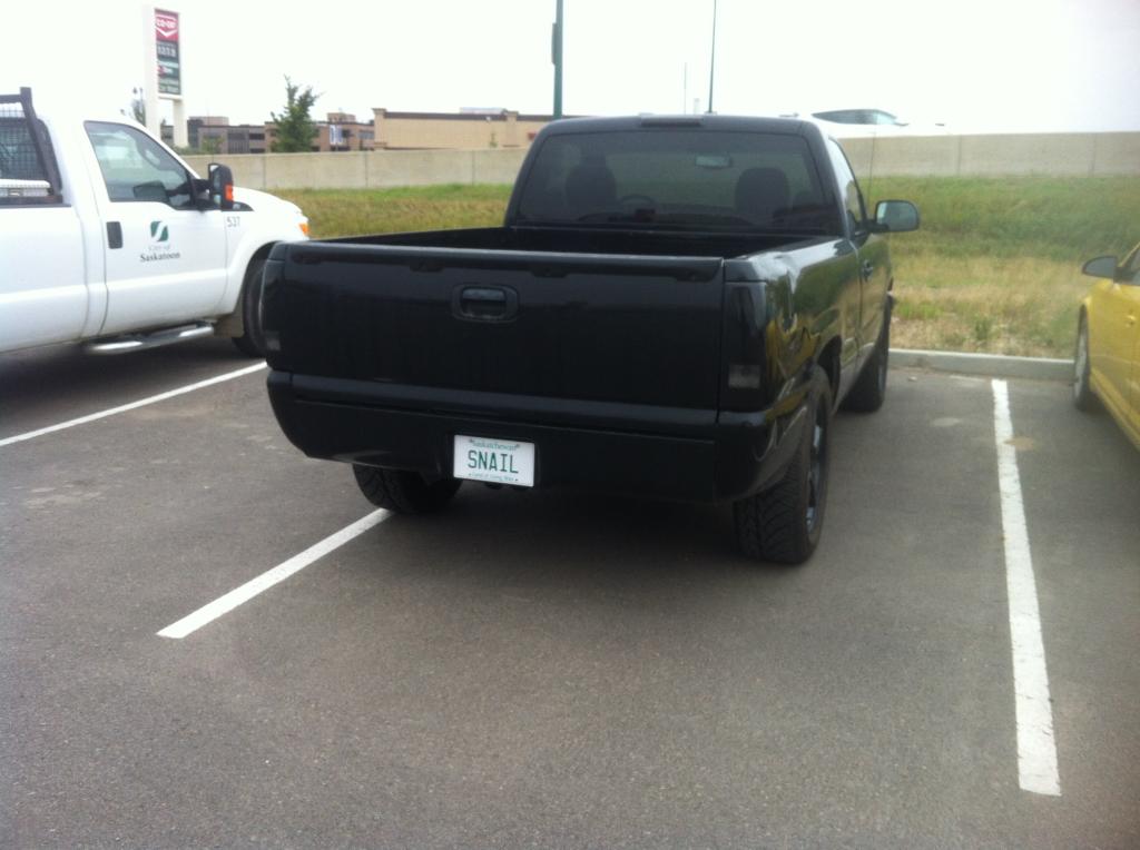

Figured I would post up the progress I've made with my truck. Bought it with the intent of just doing an exhaust and cold air with a few minor exterior things and then a turbo kit came into the picture.. Here's where it started to where it is now. Has an on3 turbo kit with 70mm turbo on 7psi

Looks really good love the exterior change have any videos?

Nice install. Keep an eye in the silicone coupler on the inlet of the turbo.

No videos as of yet but I suppose I should get on that. Running a 340lph pump with 55# injectors

I used the on3 stuff yes. The fuel pump was fine, but the injectors were a different story. 2 of the injectors were not working when they were first installed. The pins in the injector harness were pushed back in the connector and weren't making contact with the pins in the factory harness when connected together. I'm not going to strictly say don't use their injectors, but if I did it again I would not use them. I contacted on3 about this and they offered to test them and send me new ones if they could confirm they didn't work, but I had a week to do the install and didn't have time to ship them back and forth.
