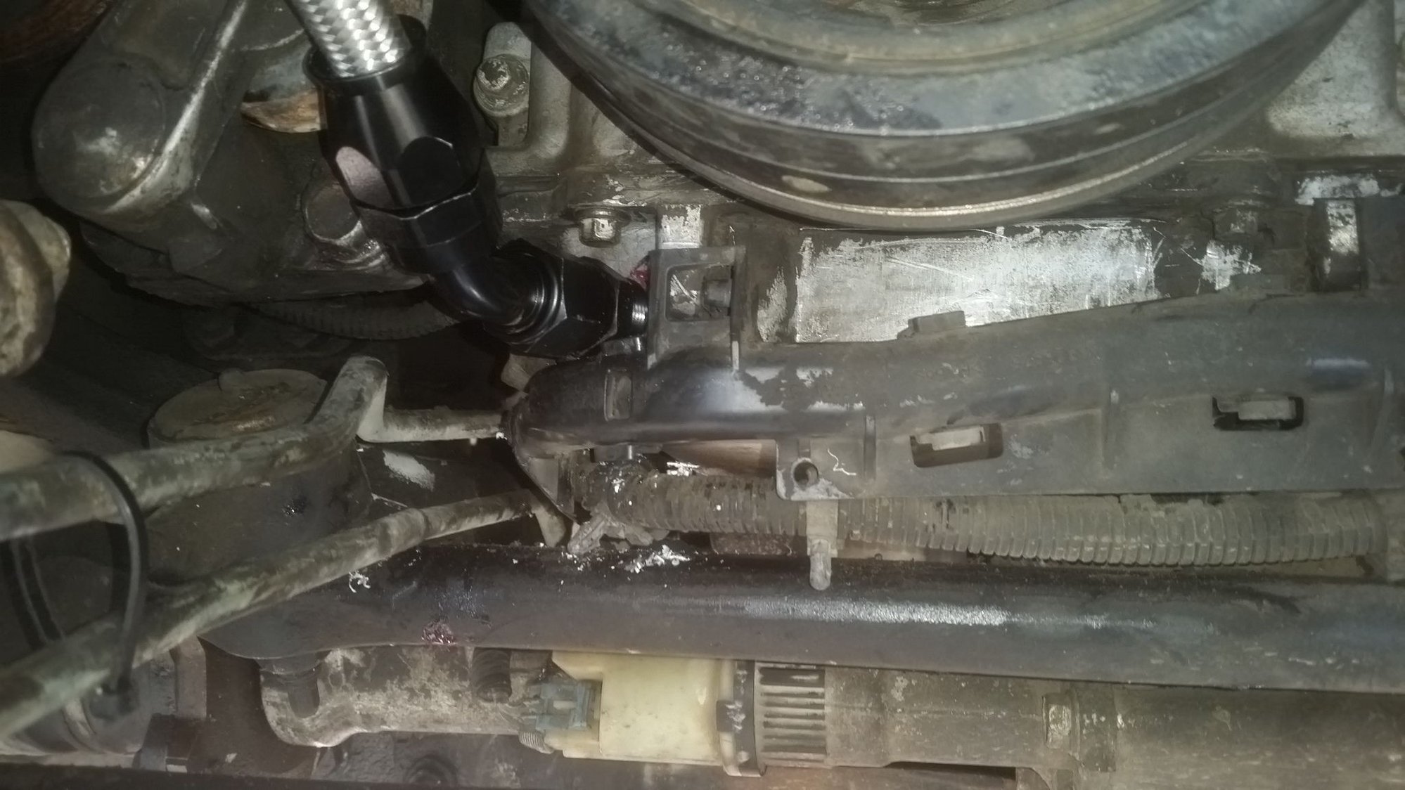

I have a 2000 Silverado with full accessories and a/c in stock location. Where are you guys putting the turbo drain on these?
thanks in advance. By the way. Turbo is going on the pass side front. Normal location.

1/2" NPT tapped into FRONT of oil pan, between crank pulley and A/C idler.
It's pretty tight, but I drilled and tapped it in place.

Passenger side between the 1st and 2nd oil pan bolt from the front.

As pictured above, drain return into fron passenger side of oil pan, so far, NOT able to install AC drive belt.
Tried a few "adjustments" to the 45 degree elbow, not happening.
Maybe a slightly longer oversize belt, say 5/8" longer ? Not SUure.
Followed the pictorial instructions in the Huron Speed download pretty carefully. Maybe my ANGLE was slightly off, don't know.
