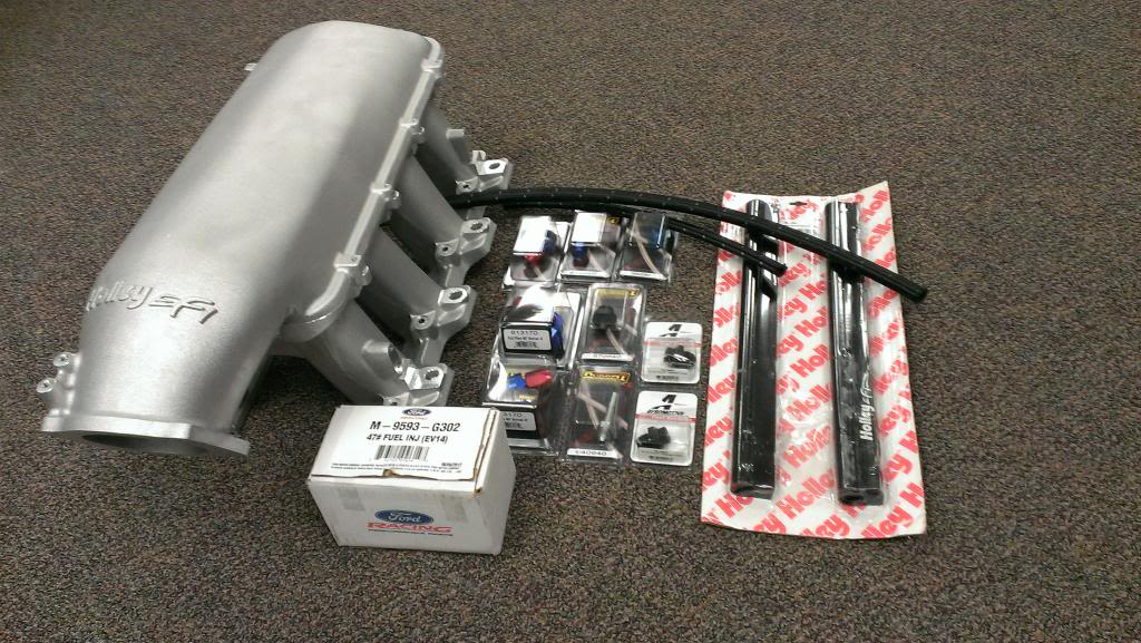

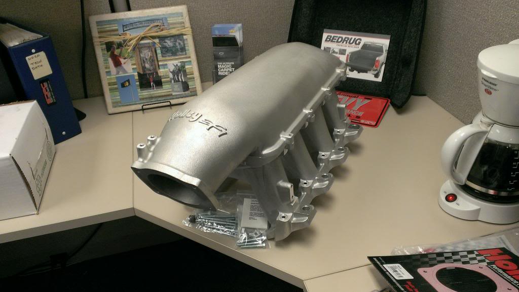

Ok long story short I finally got the whipple sold so here is the start to the new turbo build. Lots of pics to come...
Turbonetics 78/68
50mm bov
39mm wastegate
Trick performance hot side kit
Holley Hi-ram intake with billet rails
Ford Racing 60lb injectors
comp cam cust cut vvt camshaft

Originally Posted by BlackGMC
hmmm, yall have access to the Holley Mid-Rise intake? I would like to see someone actually use that intake.
As far as the intake I will get it put on this weekend so I will post pics of it Monday. As for the turbo just waiting on a bunch of parts to come in....May be a few weeks....

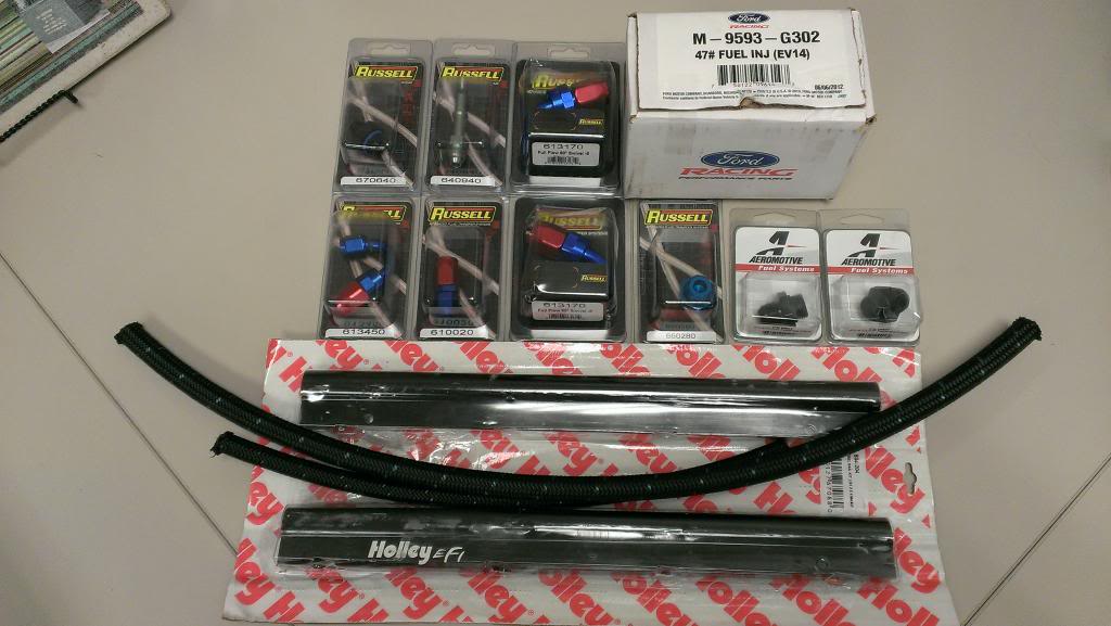

Denali08's Avatar
Joined: Dec 2008
Posts: 1,016
What are the rest of part# (fittings)? Those are for the intake & fuel rail conversion, correct?
Can u list them by PN for people wanting to swap to this intake?

Fittings list to put on intake colors will change these part numbers
russell 670640 x1
russell 630293b x2
aeromotive 15607 x2
russell 610020 x1
russell 613170 x2
russell 613450 x1
russell 640940 x1
russell 660280 x1
this will take you from 6an into the rail and every thing else is 8an
