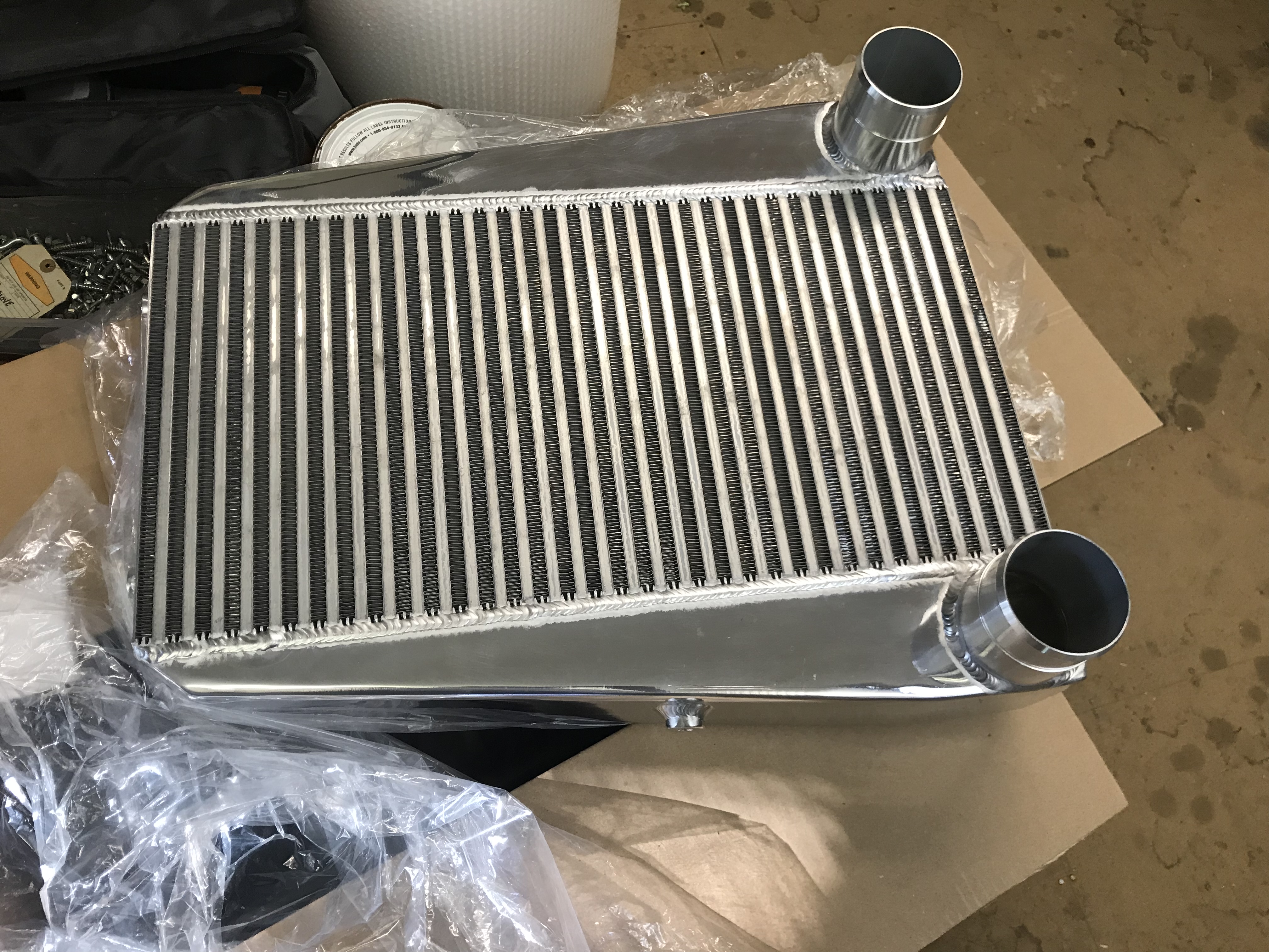

Hmm. Well, this is a big bitch. Should cool nicely.
Nice!! You’ll like it!!
