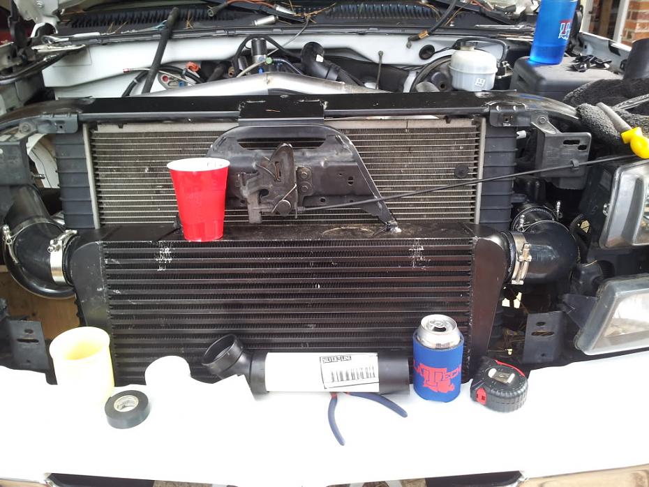

can you order that from them instead of the 34" one? would you think you'd notice any diff in temps?
I am talking about the truck water radiator. It's not part of the kit.
Depends on what you already have in your truck. You can measure the width of your radiator.
My truck came stock with 28" radiator. I swapped to 34" after having a radiator damage. And I noticed a difference in temp. It became lower with the wider 34" radiator. Later I replaced the stock clutch fan with 05+ e-fans. Those will required 34" radiator anyway to fit.
So, it depends on where you live and what type e-fans you use.
See attached pic.

ya, ill have to measure it. i though you were talking about the inner cooler. my bad. as far as the e-fans i made my own they work great. i live in az and my temps dropped a good deal. im going to be getting a stage 3 kit soon just wanto know what i can to make the install go smooth before i buy everything

Did ur truck come stock with e-fans? If yes, then u already have 34" radiator.
Here is bigger picture of the 28" radiator. You can compare to yours without measuring. The 34" radaitor will not have enough space to run the cold pipes beween the radiator and the head lights.

o ok ya i get what your saying, ill have to measure it out. im pretty sure its a 28" tho. and na i made my own e-fans

My 09 that came w Ele fan fits the stage two 2.5 in pipes between the lights and rad....
Think mine is a 34in

mines deff not 28" its 30 sumthin

2009 have good space to fit cold pipe on the sides of the radiator.
I've seen some pics for it on TrickPerf site.

You can pop the hood open and look from inside if you can fit 2.5-3" cold pipe on the sides of the radiator without the headlight interfering.
Your truck is Sierra not Chevy. Headlights size and location is slightly different than Chevy.

ya its a 2004 sierra, honestly it looks like i got quite a bit of room between the 2. good to know tho thanks man. im trying to learn what i can from urs, since im planning on trying to do a stage 3 in the next few months.
