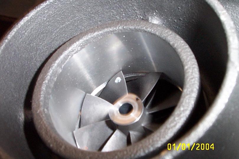

Originally Posted by 4.8T
so what do these ***** look like? oops i mean slots
I do my best these days to stay away from *****, there just trouble.
Its the slot by the wheel. It sucks from the outside and lets air reserculate when under boost but not enough airflow.

It also helps improve total airflow and efeciency by 10%.
