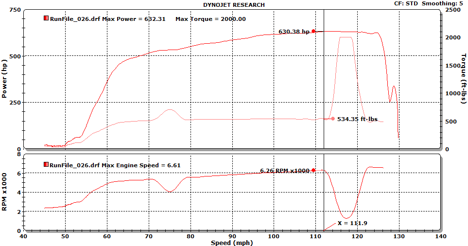

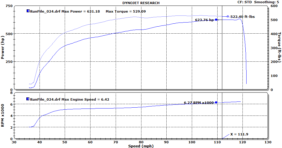

Here are two graphs. What's all your opinion? Numbers sound about right?

Old Jan 13, 2014 | 08:39 AM
  #59
Vortec350ss's Avatar
iTrader: (20)
Joined: Feb 2006
Posts: 7,271
Likes: 62
From: South Shore, MA
Dave is planning to ditch the SC series converter in favor of the PT... if you want something tighter you need the PT2800. I can't say that would be as tight as you want it either. I have measured the converter slip with mine and it is literally exactly 2800 RPM with a 6.0 in a crew cab thats flirting with 11's, but you are making more power than I am.
I think if it does stretch out a little as I add more power it will end up being a good thing though... it'll allow more cam and everything. I will say if it stretches out to a 4000 ill be pissed lol.

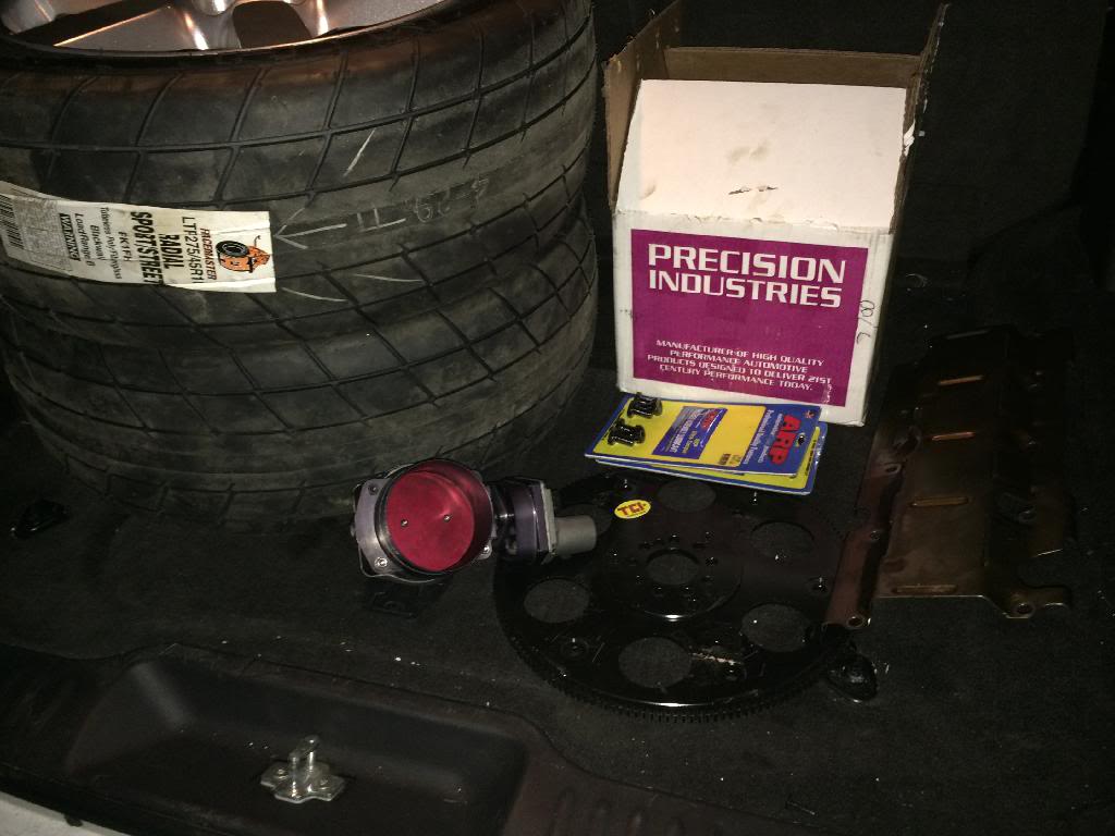

Doing some small changes. Should be back on the dyno today or tomorrow.
26-2800 triple disc, back to the TPIS 102.
