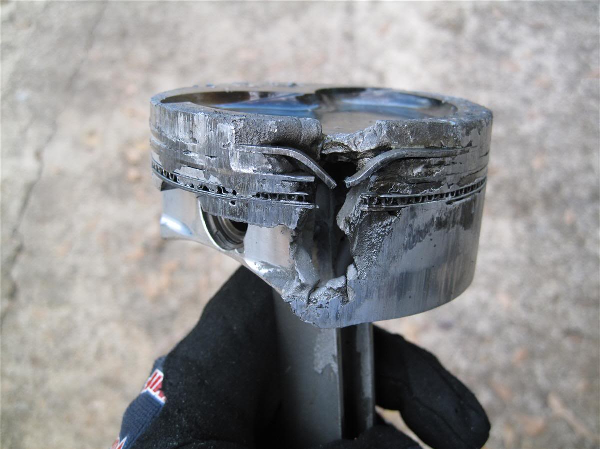

15deg with 16psi with 25% e85/ 75% 93 spraying meth from dual nozzles...
might be overly safe but im trying to avoid this happening again...

What fuel, boost, and timing caused that? And it seems like mixing 25/75% e85 93 could be a pain in the *** sometimes.?

That was 15psi 15deg on only 93...
