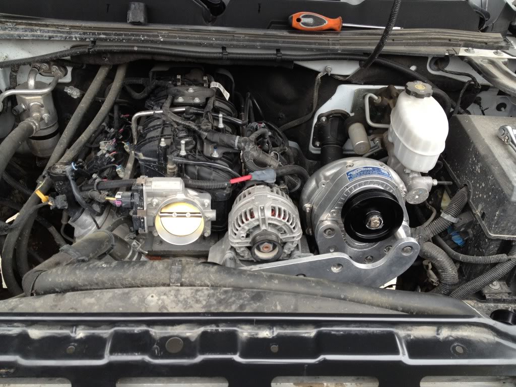

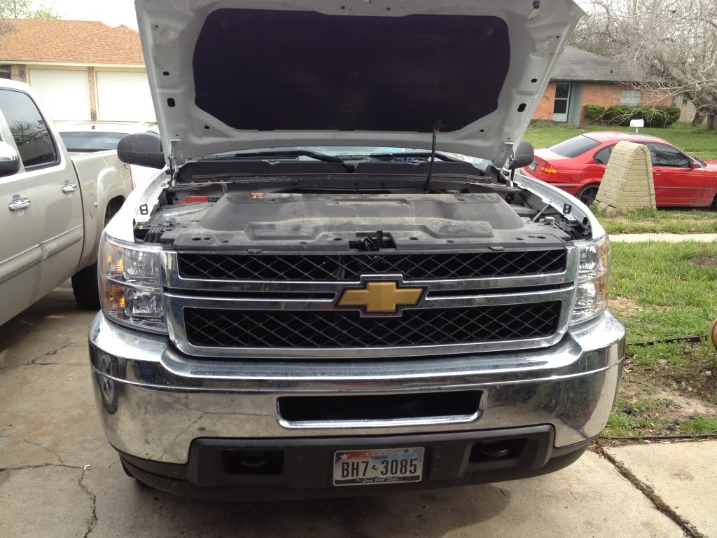

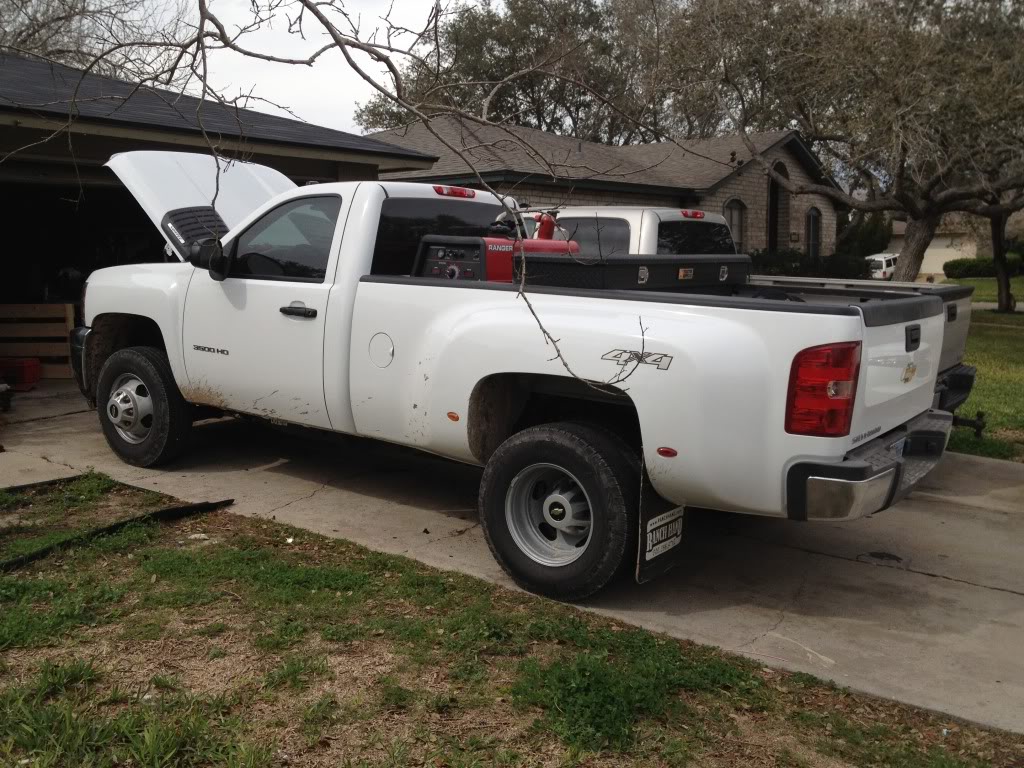

Its possible and would be great to put a maggie on it but first off tuning is VERY limited. A few months back I Procharged a 2011 Silverado 3500 welding truck (Idles 24/7 and always in the mud when out on location) and it runs great its a single cab dually 4x4. Biggest issue with the installation was I had to get new charge pipes bent as the 3500s frame and layout is a little different then the 1500s which what the kit was originally intended for. Getting back to the tuning part I had my buddy tune it with HP Tuners and right now they are very limited on what you can tune on the truck. I haven't checked back recently but I want to say its still the same. The new gas trucks use the new E68 ECM so my guess is its still too new. Im not sure about the other tuning softwares out there so maybe someone else can chime in for them. I will say this tho the new ECMs are smart as hell before we took it to my buddies for a tune we put bigger 52 lb injectors and hooked up the Procharger and the computer compensated for just about everything. It still needs a full tune just waiting on the updates but so far like I said truck runs great and yours should too. With a maggie it will def give you some good usable torque...
