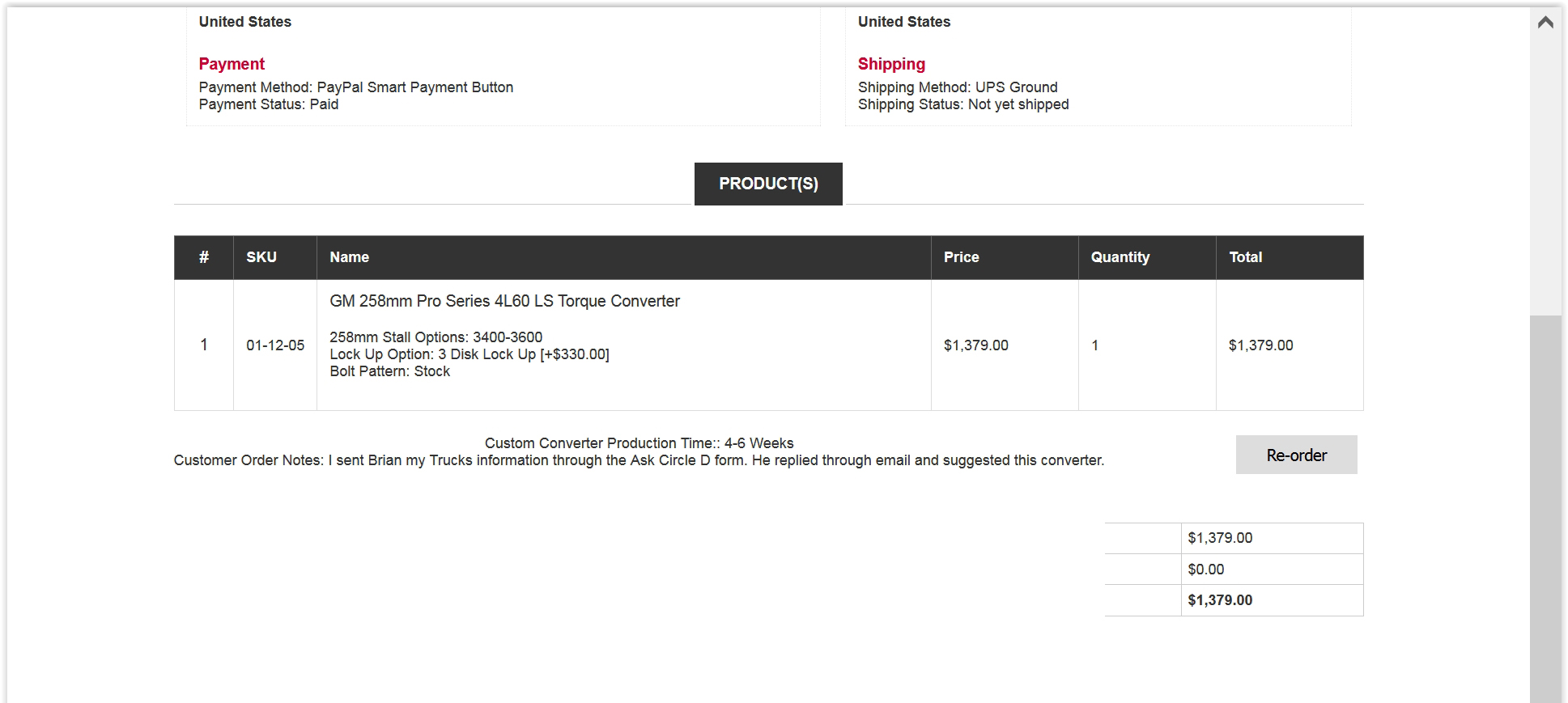

How do you know you're getting the 1A or 1B converter? Just ordered the 258mm triple disk in the 3400 to 3600 stall range. No where on my receipt does it say 1A-1B. Maybe the lower stall range 3400 is the 1A and the higher 3600 is the 1B lol

I talked with someone at Circle D about the "1A" vs "1B" subject. They stated that on the 265mm converters, the 1B is TIGHTER than the 1A.
On the 258mm converter, it is OPPOSITE. In that case, the 1A is TIGHTER than the 1B.
Hope this clears things up.
