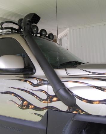

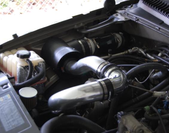

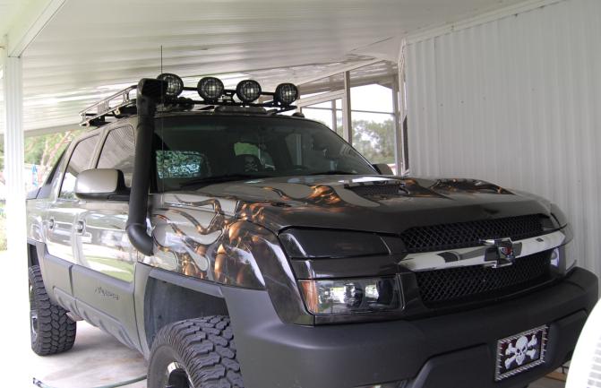

My Front mount Turbo LOVES the custom Snorkel I built for it... My IAT's are 15-25 degrees lower and they stay that way, heat soak is virtualy eliminated. The Silver intake piping is DIY Ceramic coating and since they sit behind the electric fans they are constantly cooled, and also there no hot air being pulled through the pipes from the engine bay...
But, not sure this can be compared to the rear mount style snorkel. If I had a rear mount I would run a pipe up the back of the cab to the roof with a scoop on it or something like that...
