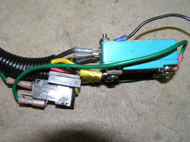

Is the green wire coming out of the loom in the right location?? It is on NC2.
Or should it go to NO3?

The green wire from the loom is attached to the N03 connection on the pressure sensor in my STS Meth kit.
