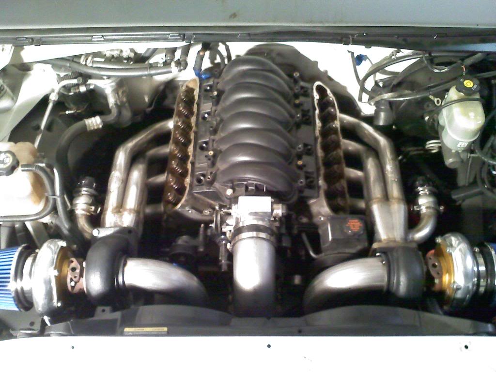

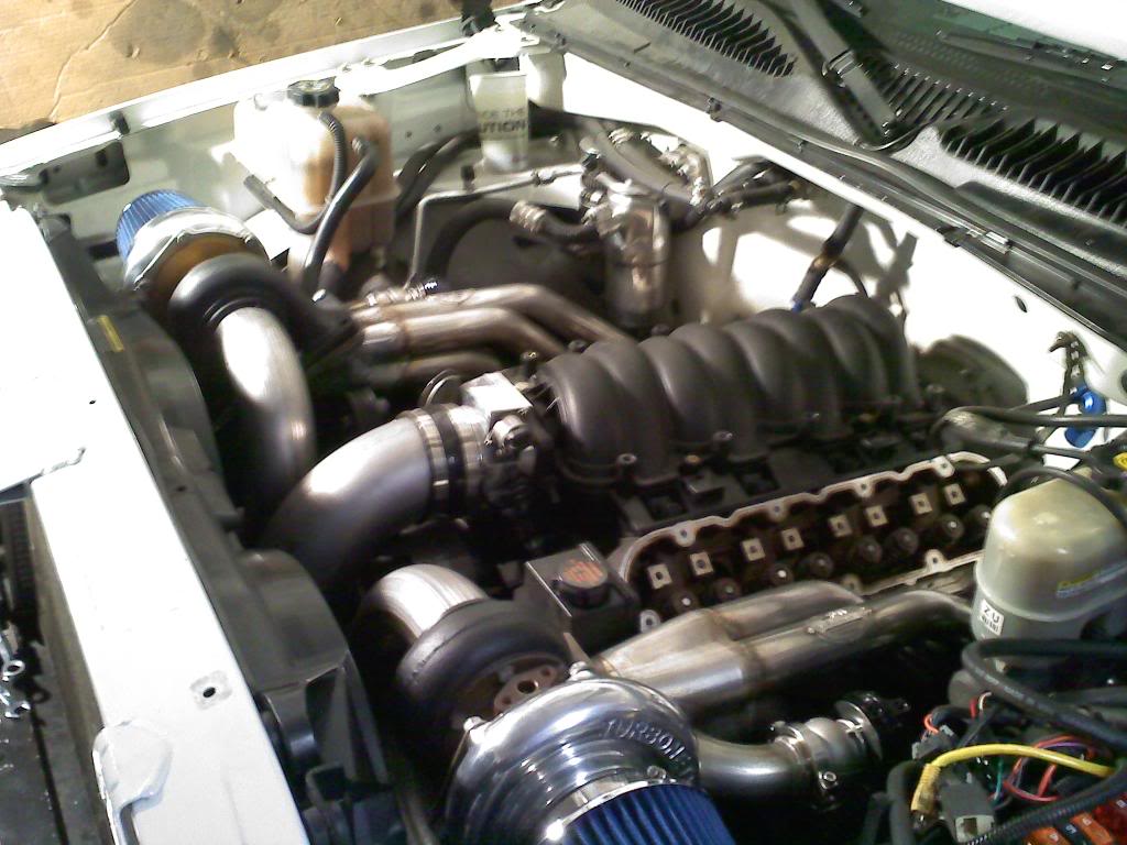

Quik (screen name) used these on his TT build in a rcsb, They are very nice pieces..I will see if I can dig up his thread
EDIT: found em'
Quik has great fab skills..and no he did not make the headers..lol..I am refering to the rest of the build (before the haters come in)

RibeiroBJJ - Those pictures looks very nice! Thank you for posting them. Do you have a link to the post? I would like to see/read some more about them.

I also used there f-body version turbo headers. They are great.

RibeiroBJJ - Thank you for the link. I do agree that he did some nice work on his turbo kit.
jasond26 - Thank you for the pictures of your work. You may have changed my idea on how to go about building my kit. I need to get my electric fan installed to see how much room I have to play with..

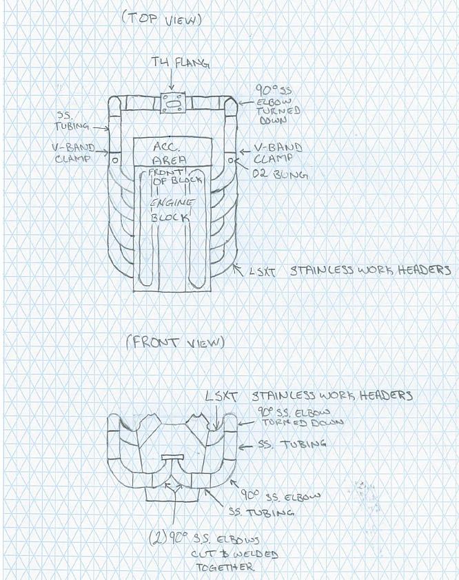

I will post up a quick drawing of what I am thinking of doing, I would appreciate any input (good and bad) on my idea. I just want to build the best kit possible for the best price.

here is a quick sketch of what I am thinking. I would like any opinions. Thanks
