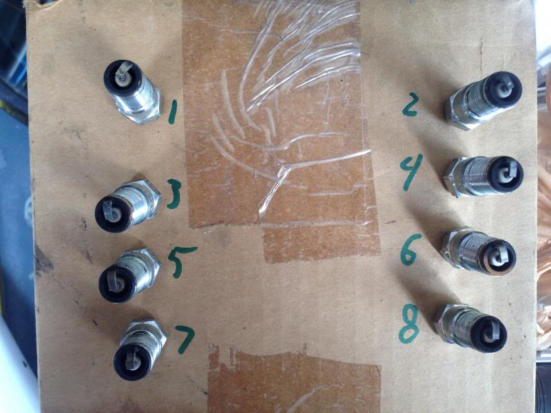

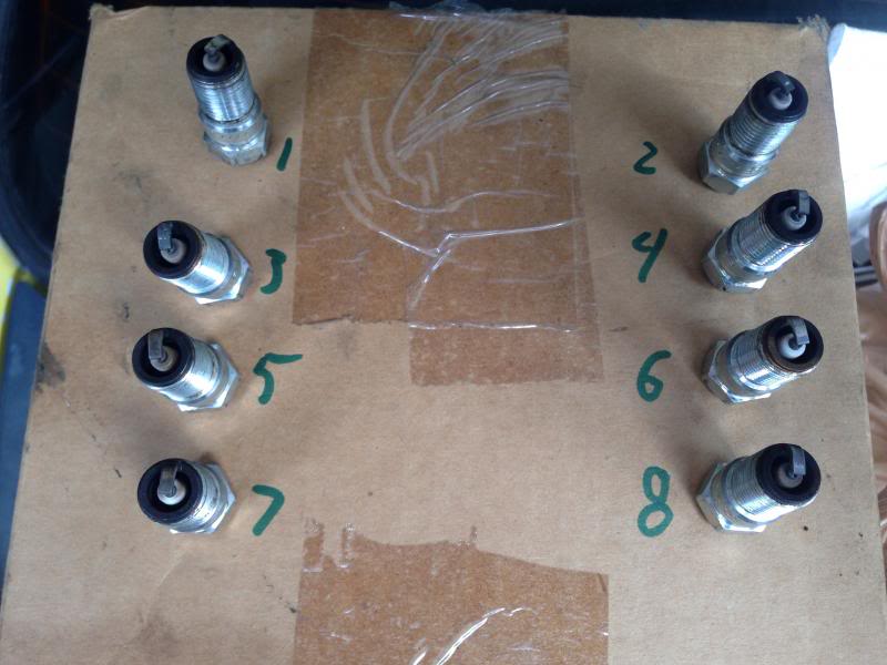

I took the br7ef's out today. Here is what they look like.
The left side of the motor had used plugs from before the motor went. So the browning was already there. But not the black and the strap changed also.
