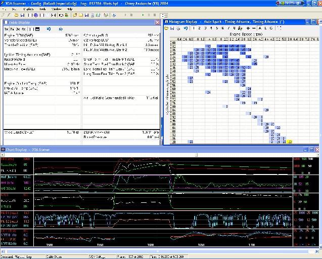

Here is a JPG of 22* non-intercooled timing with a snow meth kit in 80* Florida Sunshine.... Notice the 186.31 kPA reading on the 2 BAR MAP.......
This was before I went to a 2 BAR SD OS because I am way beyond what the stock MAF can read... notice the MAF is pegged at 63.55 lb/min... that is it's upper limit....

I can't read anything on that log. It appears the resolution is too low, but how do you read 186kPa without a 2 bar OS.

Edit: sorry I didn't answer your question about the 186 kPA... guess you missed the part where I run a 2 BAR OS with HP Tuners and prior to that I helped my engine survive by inputting a 2 BAR MAP sensor into the MPVII interface as a analog input in tandem with the stock MAP sensor to check scale and linearity of the sensor prior to installing the 2 BAR OS. But that is tuning talk... I expect that may not make sense to ya... and yes, our rear view mirrors are full of broken G80's and 60E's just like everyone else... that is not in question here... just your statement about the 10 psi threshold....
