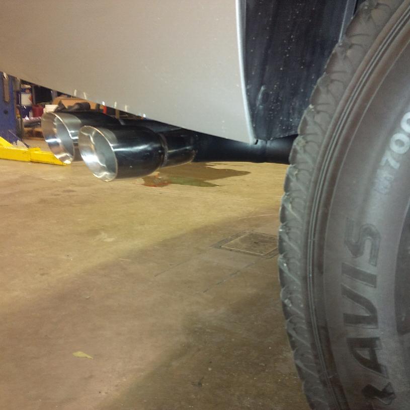

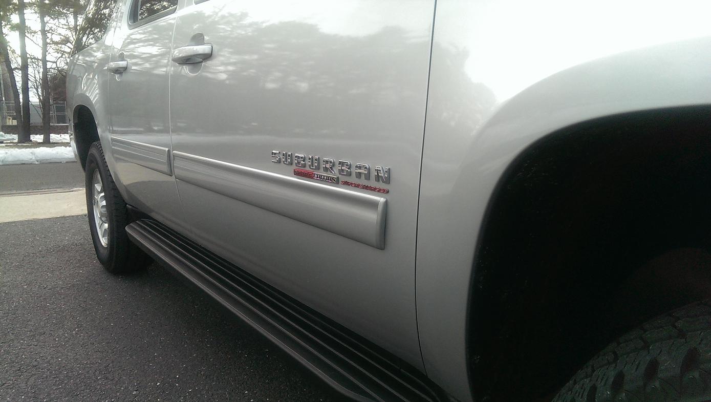

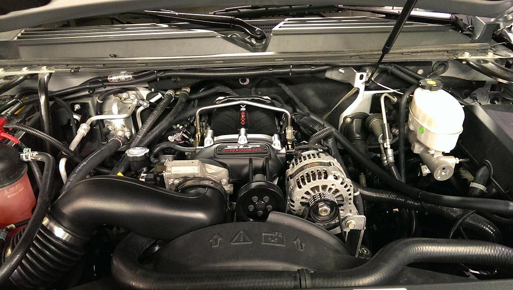

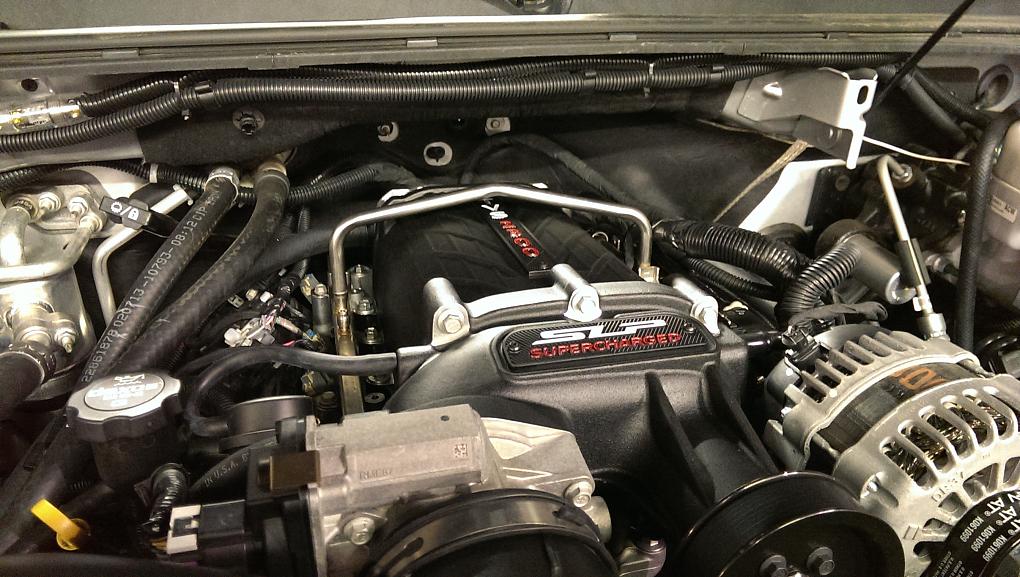

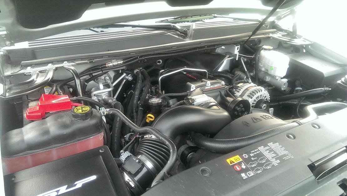

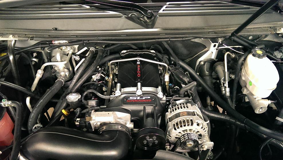

Took delivery of the Burb late last week.
I would like to start off by saying the guys at SLP did an excellent job and the level of customer service is unmatched. Their Engineering Manager, Hank Daniecki, made sure this thing went off without a hitch throughout the whole install. The install couldn't be cleaner. I highly recommend this package to anyone that can spring for it.

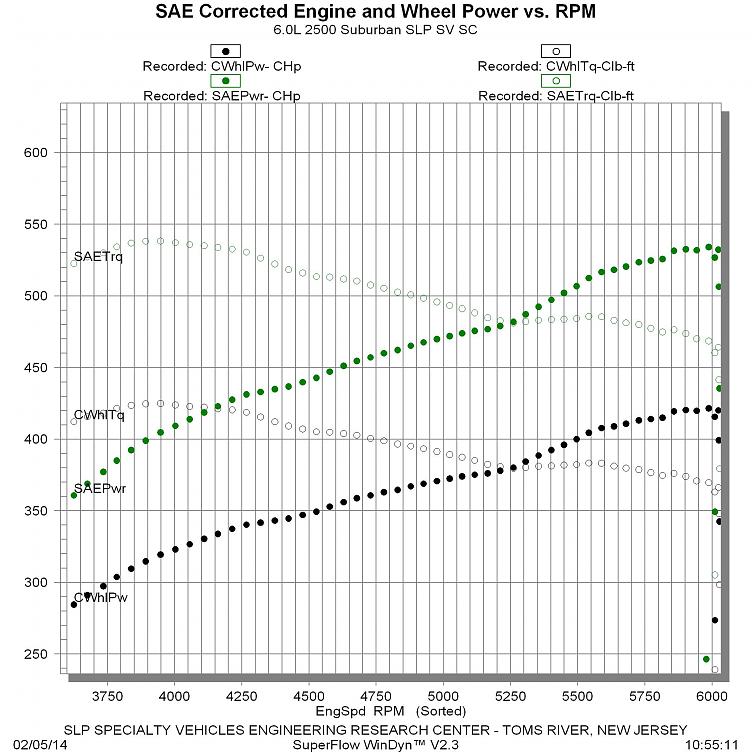

The Burb dyno'd 534 flywheel HP and 538 flywheel TQ. 421 RWHP and 425 RWTQ, making about 7.5 PSI on 3.8" pulley, and also has SLP's 1.85 rockers and CAI. Since my truck is a 2500, it has 3.73 rear and is a huge compliment to the overall performance. The addition of the Hellwig rear sway bar helps in managing the power. The truck has also been lifted 1.5" in the front via torsion bars, leaving it almost level with about .5" rake.
I still cannot believe how this 6600# pig can move like it does.
Take a look at a couple pics

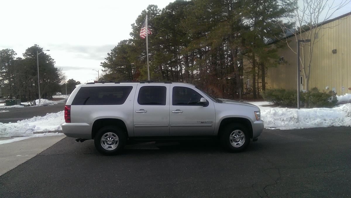

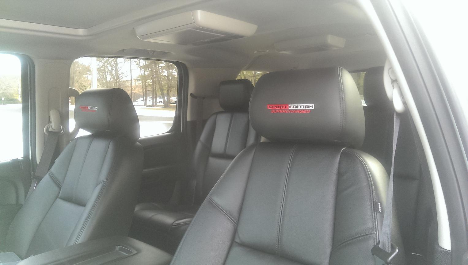

more pics
