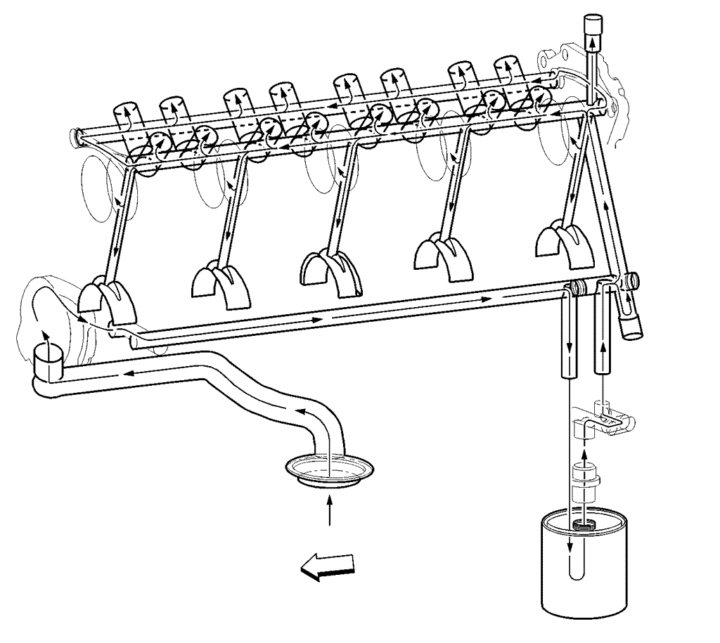

Interesting. Isn't that spot at the very end of the oil path in the motor? I would rather feed my turbo from a spot that is closest to the oil pump (spot above the oil filter) rather than a spot furthest away...
Actually, it is early in the oil flow path. Here's the schematic.

your schematic shows him being right, pickup - pump - galley - filter - pressure sensor - lifters - cam - crank- back to pan
