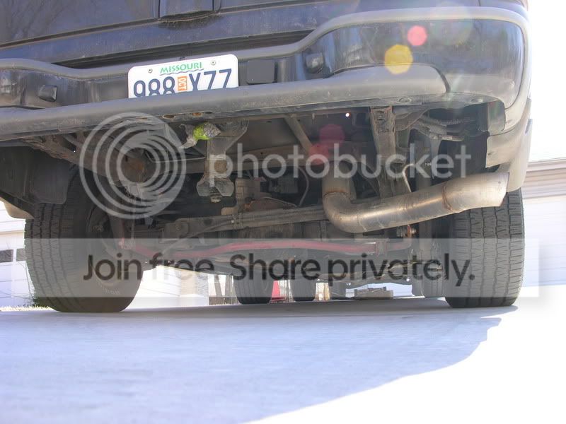

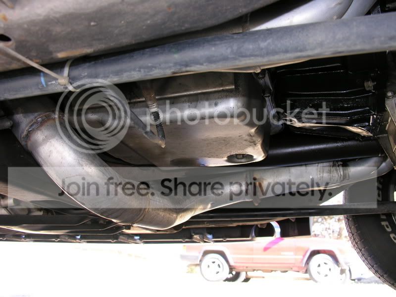

I was making about 480rwhp through pacesetter's, 2.5" y-pipe, and a single 3". I think it was choking me down a bit, so I upgraded. Last weekend, I stepped up to 3" pipes off the collectors into a 5x11x22 magnaflow, with a single 4" outlet.
looks stock...
ok.. maybe not
band clamps for easy removal... already planning for the tranny swap.
