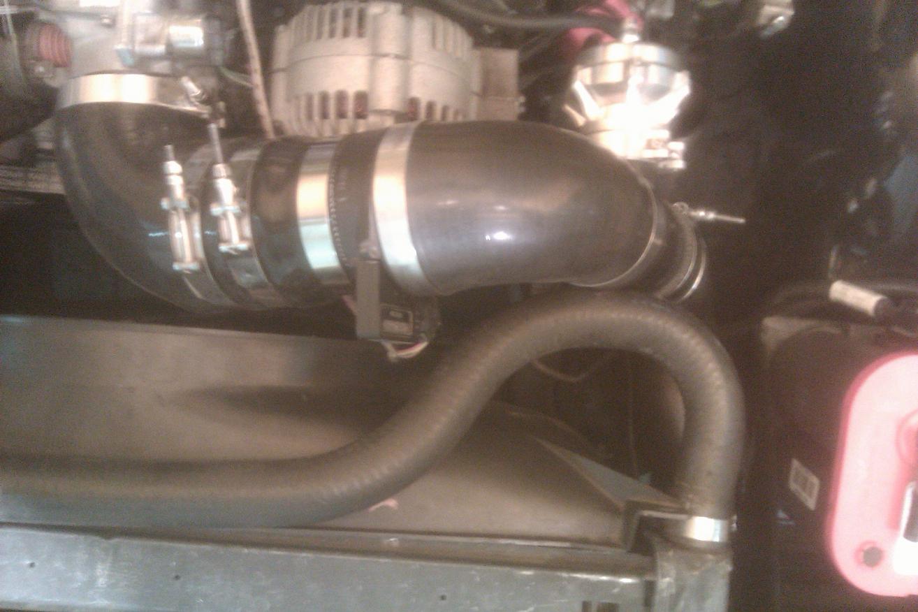

ok all still need help. I am waiting to hear back from my tuner as I really think it must be a bad tune as I cant seem to find anything that points otherwise.
On a last thought is my MAF placement. You can see in the picture it is in some bends, I didnt think that would hurt anything but now have read some stuff talking about turbulance or feedback or something. I am going to attemp to log some tonight or for sure tomorrow. I have logged some but didnt get the MAF frequency I now have it in there to capture.
If you can think of anything I need to check let me know. I am at the mercy of the tune right now and it is about to drive me crazy.
