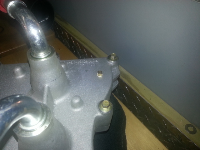

I'm going to be installing my roush kit on Sunday and I have an auto meter mechanical boost gauge I want to install. Is there a vacuum line I can tap or will I have to drill and tap? If I have to drill where can I find the fitting that would go on the manifold? Thanks for the info guys.......

Most people drill and tap for a 1/8" npt fitting. I am using a digital boost gauge and the standard size for most boost gauge sending units are 1/8" npt. Here is where I drilled for mine.

My manifold is drilled and tapped in the same location as above pic.
